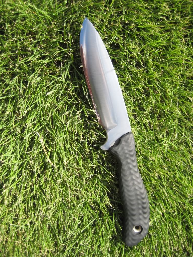

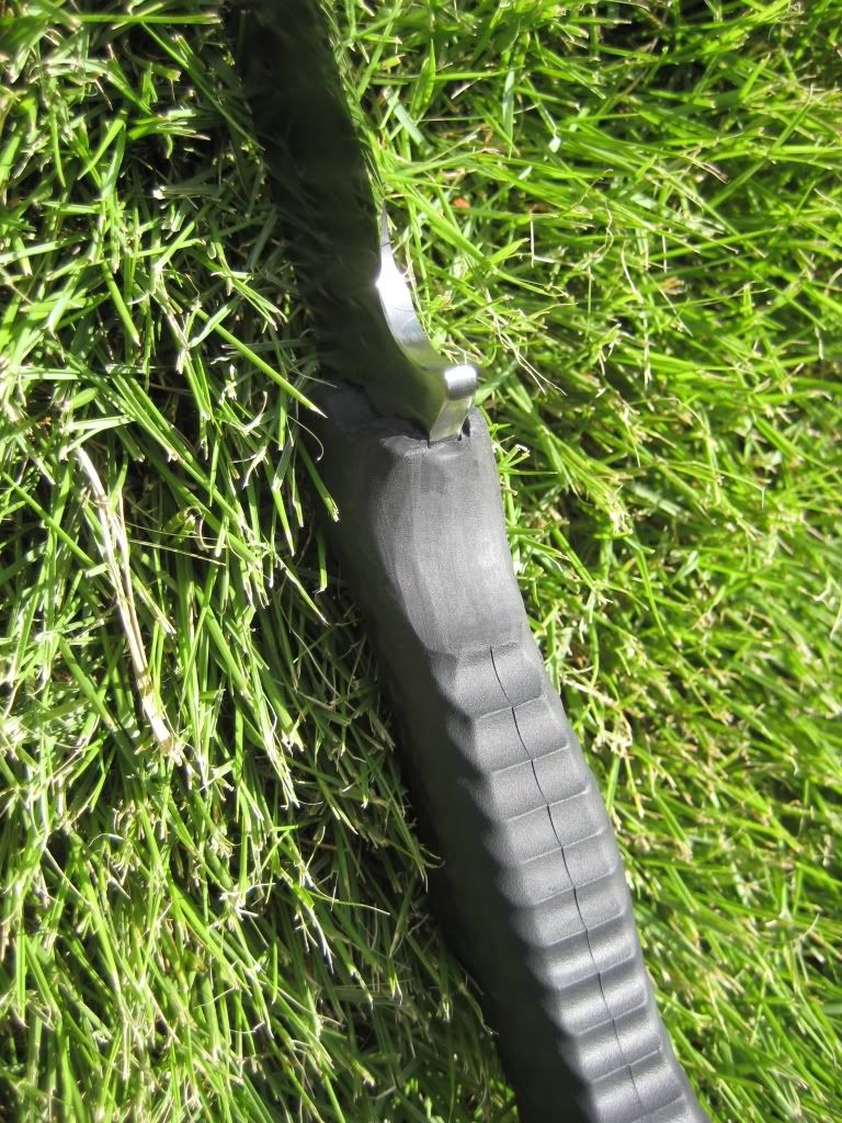

Here is the best pic I could get so far:
Modified Res-C and Choil:

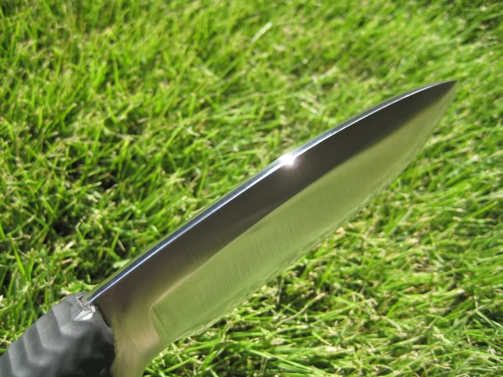

Blade pic:

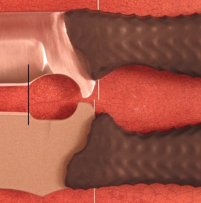

Compared to non-modified S5CG:
The above picture should have the choils lined up at the front of the choils - as I made sure NOT to grind the choil forward into the blade edge.
So, the above pic makes the guard look possibly ground from the back/handle side. It was not. It was ground from the choil side and enlarged into the guard.
The above pic should have been aligned like this:

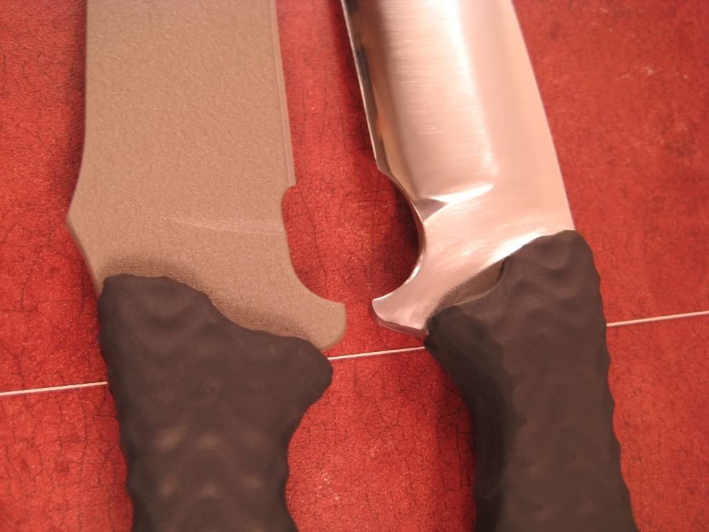

Another close up comparing choils and modified Res-C (not a good angle, but I kept getting glare <img src="/ubbthreads/images/graemlins/frown.gif" alt="" /> ):

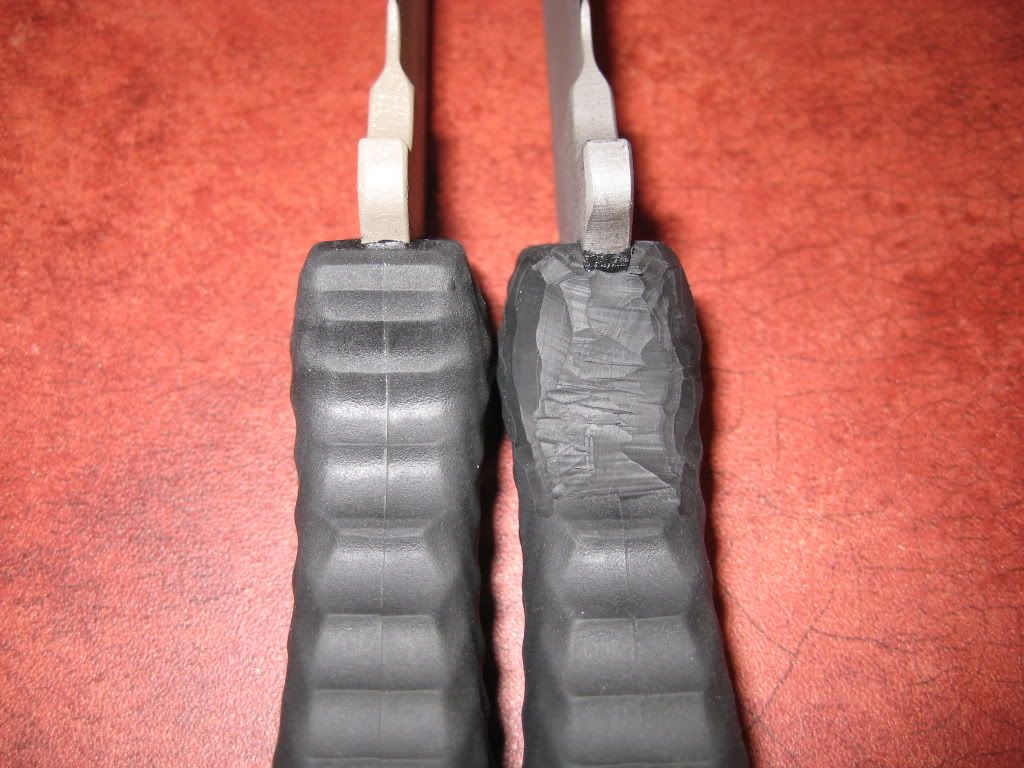

Pic of first step of modification to Res-C. I used a thin and narrow sharp blade to shape it. I think this modification made HUGE improvements to the feel of the knife. But, if anyone else attempts, make sure to be careful to NOT CUT TOO DEEP. If you cut too much Res-C, you get to the tang and will have too thin a layer of Res-C.

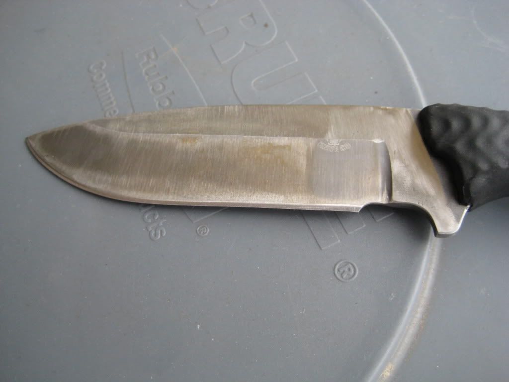

Here are a couple of pics taken shortly after just starting to grind.
Notice how VERY quickly SR-101 will rust. That rust develops within a few minutes while I dunk during grinding. And that was with wiping off most of the excess water. <img src="/ubbthreads/images/graemlins/ooo.gif" alt="" />
