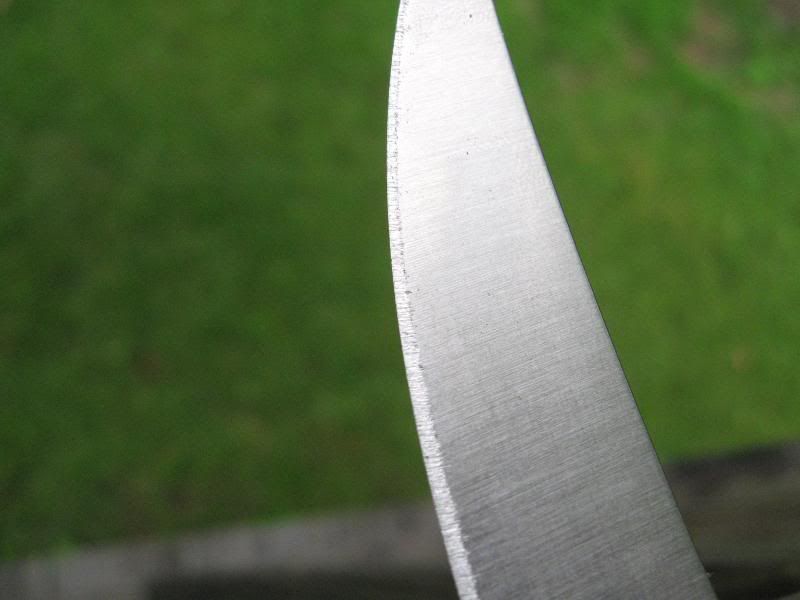

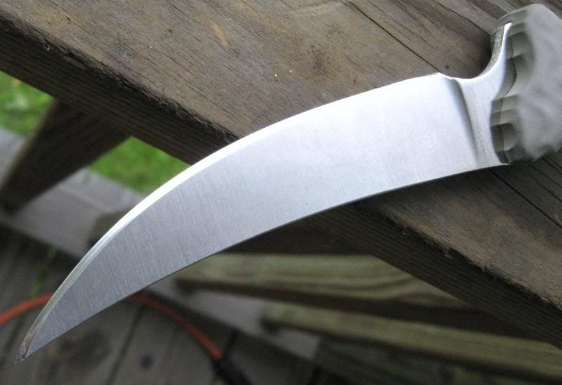

I am learning how to work with this 154CM. It is hard and heats up fast when grinding, but man does it ever take a sharp edge. The Bird Dog is such a nice EDC slicer and small game knife. All it needs to be perfect is a little TLC on the edge. Here is mine with the factory edge.

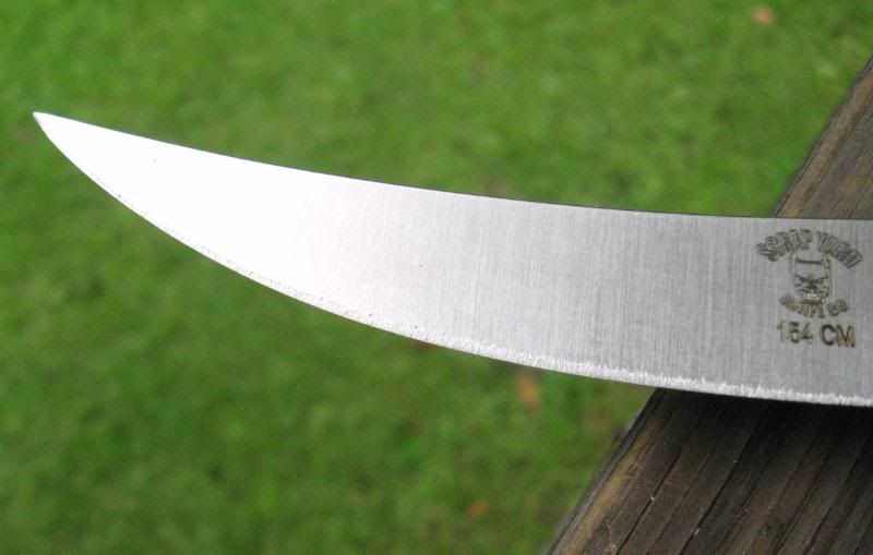

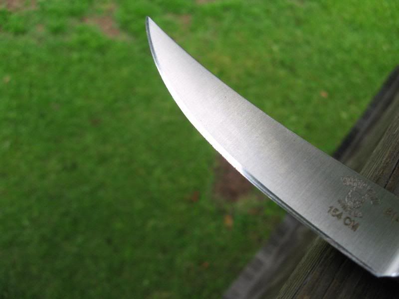

As you can see, it is a little rough for this type of knife. So I reground the edge with a 120 grit. Then I went to 180. Then 40 micron, 15 micron, and final polish with 9 micron. This took me about 15 minutes on the belt sander. Now the edge is worthy of this very fine little knife.

Sweet looking edge on that...looks really sharp too.

It will shave easily. I am very impressed with this steel. I know it will take longer to do this edge without a belt sander, but I would encourage owners of the BDLE to take the time to put a good edge on it. The knife is worth the effort and will be so much more useful when sharp.
