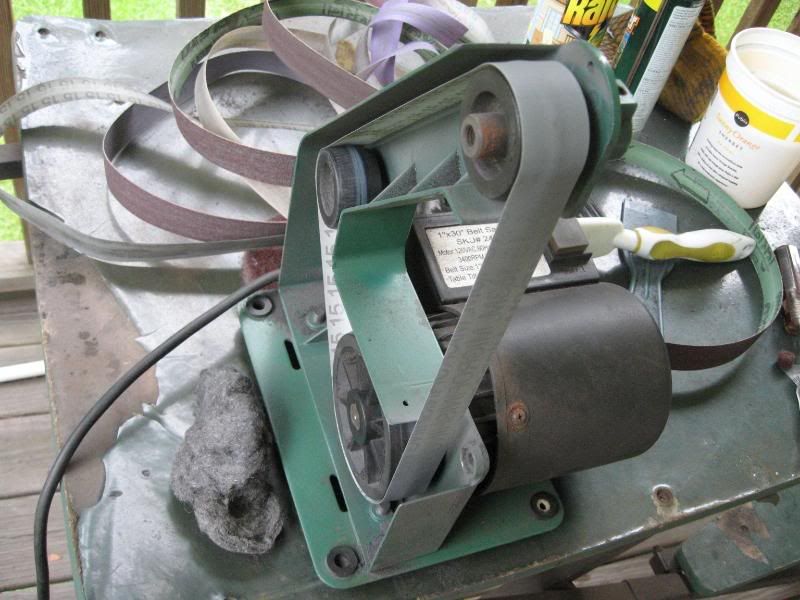

Once you get the belt sander, to use it as a knife grinder, remove the covers and table, and either remove or move back the platen so you can do convex grinds and have room for big blades. You may be changing belts often, so leaving the cover off makes this much faster and easier.

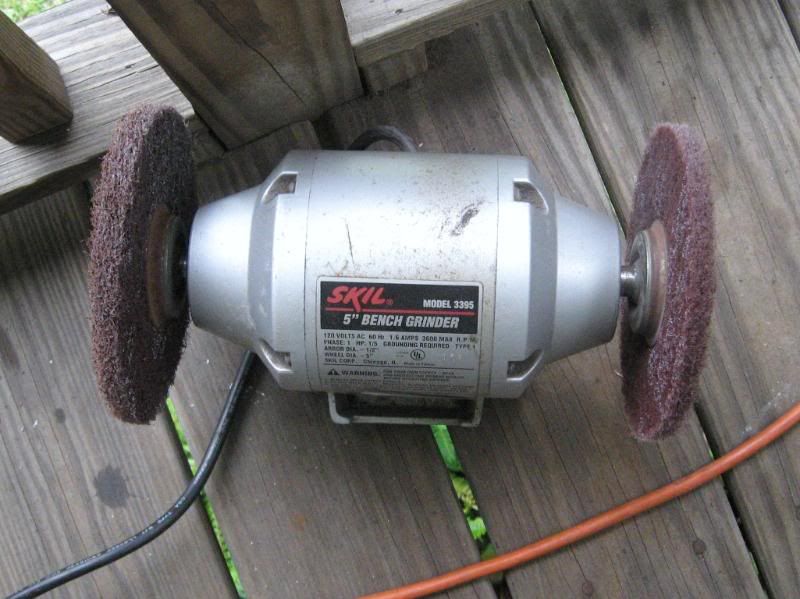

Another really useful shop tool is an ordinary 1/2" arbor bench grinder converted to a buffer using Scotchbrite wheels. Once the grinding is done, you can soften the glare on the finish and give it a nice brushed satin look.

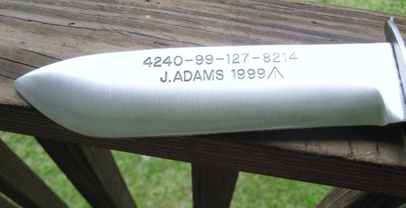

How does your MOD4 perform with it's new convex grind now Vic ?
Re: Anybody Use These Belts..Grinding/Polishing/Ho [Re: pitman] #245297 09/26/08 03:36 PM
Like yours, I imagine, pitman. It is like having a knife I hated turn in to one I like. It is like a different knife. Also, removing all that steel improved the balance and feel of the knife, too. It is still a heavy knife with that full tang and all. I noticed that yours had a narrower tang. I made mine as much like yours as I could, though and it cuts very well. Not the hardest most edge-holding steel, but easy to sharpen.

I ordered McMaster-Carr's premium 1x30 belt (orange belts) for stock removal. Man it turned my HF into a beast! It will grind a blade from stock in about half the time now. Before I was using the belts from Home Depot - They're good for wood but don't last long with metal.
The second HF is outfitted with 4000 grit for final edge finishing.
[Linked Image from i247.photobucket.com]
Here's the difference in thickness btw the McMaster belt and a Home Depot belt.
The HF didn't want to turn these at first - too stiff. I had to leave these out a while to soak up humidity. Once it got rolling it was on!
