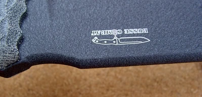

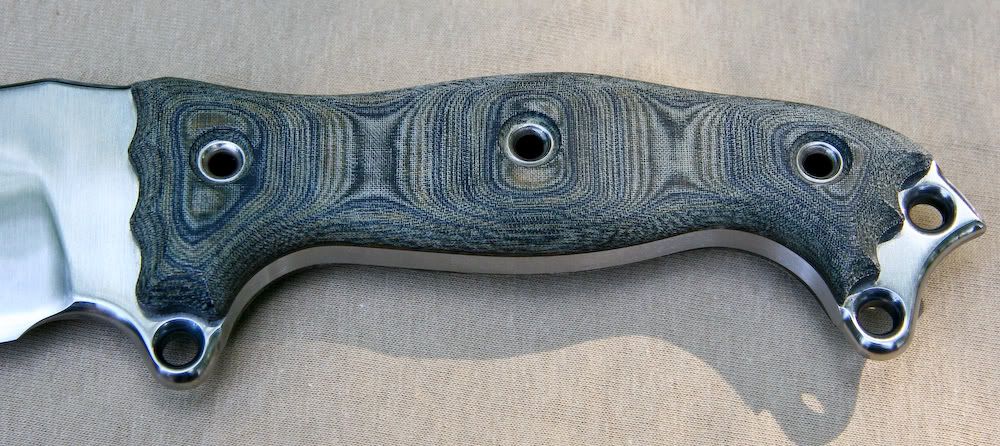

since we're on a nmsfno jaunt whats up with the nuclear meltdown...im really not a fan of it...why is it sought after?
I honestly haven't heard much comment on the Nuclear Meltdown treatment.
Some seem to modestly like it. Some are not big fans.
Personally, I have mixed feelings.

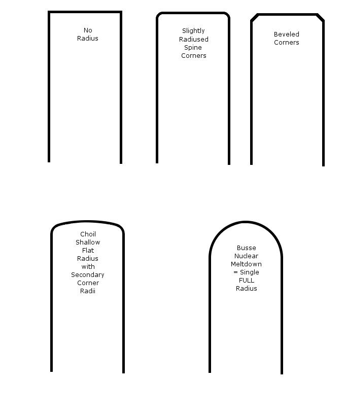

When stripping a CG, I tend to put radii or bevels on the corners of my knives at the spine and choil for comfort.
Most of the Scrap Yard and Swamp Rat LE's are fine as they have been - IMO. <img src="/ubbthreads/images/graemlins/thumbup.gif" alt="" />
Many of the CG spines don't need much - just a slight rubbing with some sandpaper by hand or a few quick passes on the belt sander.
A lot of my CG's needed a bit more tweeking/modifying and radiusing in the choil areas to maximize comfort - IMO.
But, sometimes, I am just getting carried away trying to make it "Perfect" <img src="/ubbthreads/images/graemlins/loopy.gif" alt="" /> - when just very subtle mods would be more than sufficient in most cases. <img src="/ubbthreads/images/graemlins/thumbup.gif" alt="" />
Sharp corners are just not comfortable - especially at the choil.
The way Jerry did the NM (Nuclear Meltdown) Treatment is sort of the far end of the radiusing spectrum to me vs. just square corners.
With square corners, you get two sharp outside corners, but a flat surface area in the middle.
With the NM Treatment, the sharp corners are radiused to the Max, but that leaves more of a "Peak" in the middle.
I typically just put a small radius on the outside corners of the spines of my knife - Or a small flat bevel of about 45 degrees and leave much of the top of the spine flat. For my thumbs, the flat surface offers a good purchase and control, while the subtle radii or bevels are sufficient to knock down the sharp corners. (See picture - Top Middle and Top Right)
To me in feel and function, the small radius vs. the small 45 degree bevel are very similar and mainly only vary in aesthetics. They both look and feel fine to me.
For my choils, I like a "Trigger"-Style (compound) Radii (See above picture at bottom left) - where I put a shallow radius in the middle instead of a flat or peak and then further radius the corners to transition smoothly from shallow radius to sides. This feels best to me in the choils and on my index finger.
For me, the NM treatment is still very decent at the choil area and feels fine to my index finger. But, I am not so big on the NM treatment's Peak for my thumb. The NM's "Peak" just doesn't feel so great to my thumb. <img src="/ubbthreads/images/graemlins/confused.gif" alt="" /> I would rather have a flat thumb ramp/notch with the corners slightly radiused/rounded. Again, I find having the corners slightly knocked off helps in comfort, but the NM's Peak just isn't quite as good. A flatter surface or only a very slightly radiused spine offers better feel for my thumb.
For my purposes, the NM choil is really sufficient and almost as good as my slightly preferred "Trigger" shape.
But, I should note that I find "Feel" of choils varies depending on thickness of tang.
All I really need to do to improve the thumb notch is to just flatten out the peak of the radius a bit = generally pretty easy. <img src="/ubbthreads/images/graemlins/thumbup.gif" alt="" /> .... and since the SFNO thumb notch doesn't quite feel right to me anyway, I was almost assured I would be making a modification to the thumb notch anyway. (Sort of like how I modified the thumb notch on my HRLM.)
Another issue worth pointing out is how various spine radiusing can affect batoning. Without any radii at all, sharp corners tend to tear up a baton.
I think the NM treatment is slightly better than sharp square corners, but the NM's peak could still cause baton wear faster than either of the other two options. For batoning, I would think the compound "Trigger" type radiusing would be best. But, I don't think there is much worthy difference for batoning between most of the spines so long as they don't have a swedge or sharp corners. The batons I use in the woods are cheap and burn well. <img src="/ubbthreads/images/graemlins/wink.gif" alt="" />
However, I do think the NM treatment looks pretty nice - Unique for one and two (if nothing else), I appreciate the "Effort" and intent to provide an improvement by radiusing.
Although, I would probably vote for the compound "Trigger" style radiusing if one type were to be used for both spine and choil. <img src="/ubbthreads/images/graemlins/thumbup.gif" alt="" />

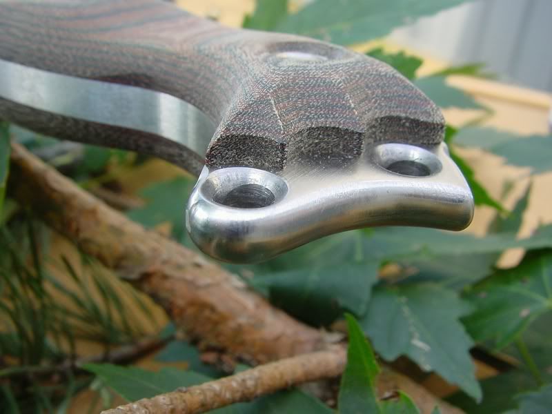

I "AM" a fan of the full radiusing of the lanyard holes. <img src="/ubbthreads/images/graemlins/thumbup.gif" alt="" /> - Nothing but benefits there - IMO.

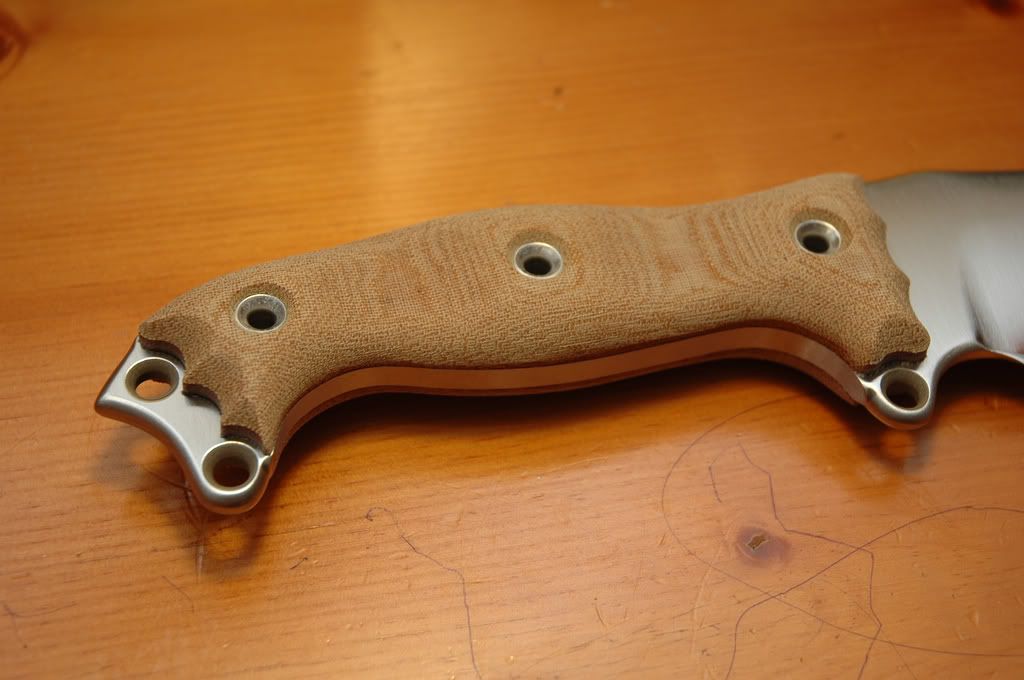

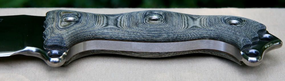

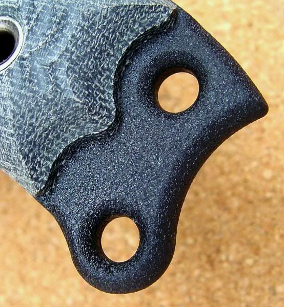

The following pics are borrowed. I don't have any NM LE's. But, they show the NM treatment pretty well:
NM Treatment on CG NMSFNO:
NM Treatment on CG FBM that was stripped and satin finished by Ban:
[img]http://i80.photobucket.com/albums/j183/DWRW/Busse-NMFBM-strippedbyBan1c.jpg[/img]
