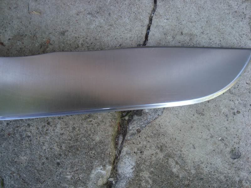

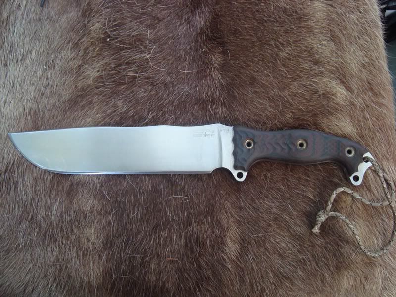

The Belt Sander - This is probably one of the cheaper set ups. I use a grizzly 1x30 which I think was probably around 50 dollars. I have belts ranging from 40 grit to 15 micron, to loaded leather, to loaded cork. I've got it all. This is the single most versatile system in a knife sharpeners arsenal, bar none! After I sell the EP i'm going to purchase a Kalamzoo 1x42 sander just to have adjustable tension. You can take a knife with a thick saber grind and coated blade and turn it into a full convex with a satin finish. You can remove chips from a blade, thin out grinds etc.. Nothing gives me a sharper edge. Take your time and practice on cheaper knives as well. I've thinned out knives too much as well on this, trying to test the limits of what INFI can take in terms of thinness. Pay close attention to the tips and the area around the choil as well. I can get an edge sharper and more durable on a sander than any other method, faster too. For a non convexed or damaged edge I work my way up from 320 grit all the way to 15 micron. After 15 micron I started doing something different as on the cheap 1x30 sander, the leather belts become useless when they stretch. I started using a cork belt that I basically knocked all the grit off of, and loaded it with green compound. I find this works much better for me than the leather. I also hand strop after with pink compound. Convex is easier to maintain as well, I won't sharpen this FBM again for probably 4 months or so, and then it'll just be with the loaded belt. I occasionally strop on my jeans. I just sharpened this this afternoon, scary freaking sharp.
[Linked Image from i437.photobucket.com]
This is what has worked for me, not what has worked for everyone. Some love other systems, some like just a ceramic rod, some just a medium stone. Do what works, i've found what works for me.
