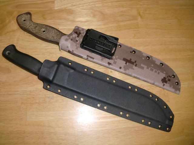

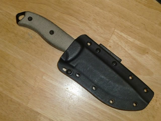

Pics help more than words sometimes
Here is a taco, the desert camo one and a pancake the all black

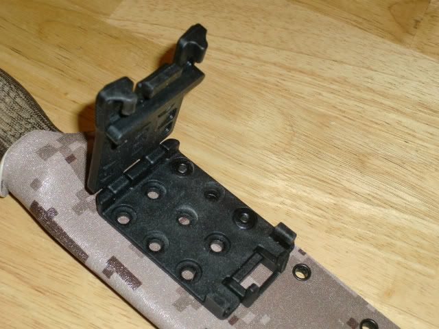

Here is a close up of a tex lox open in the vertical position
[Linked Image from i1110.photobucket.com]

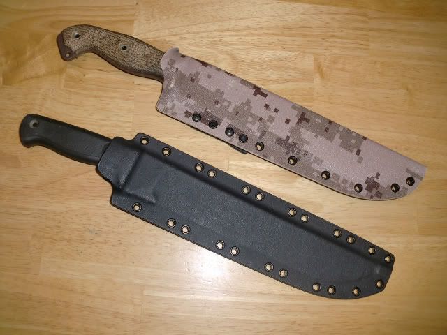

here is a pancake from one piece of kydex from the above pic

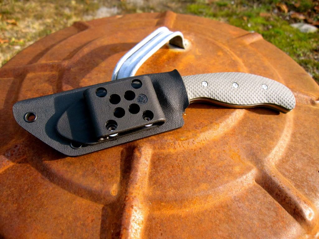

Here's a pic of the G-clip too. <img src="/ubbthreads/images/graemlins/smile.gif" alt="" />:
[Linked Image from i1181.photobucket.com]

Thanks for the pic, Doc. Are g-clips harder to obtain? The makers I've looked into seem to only offer tek loks.
Re: kydex questions from the ignorant... [Re: Jason G] #612415 01/22/12 12:03 AM
Joined: Aug 2011
Posts: 48
Dr Heelhook Offline
Joined: Aug 2011
Posts: 48
PM sent.
