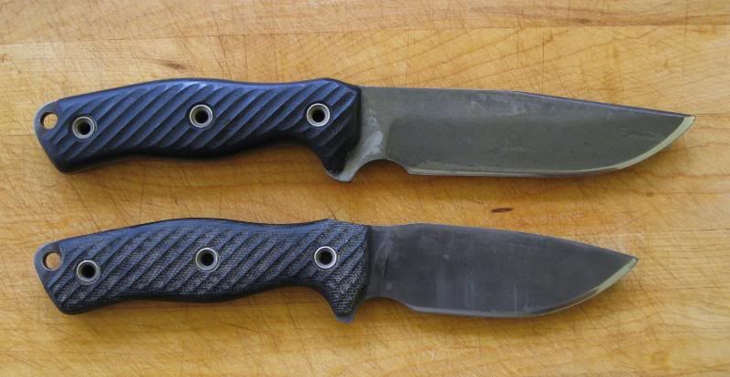

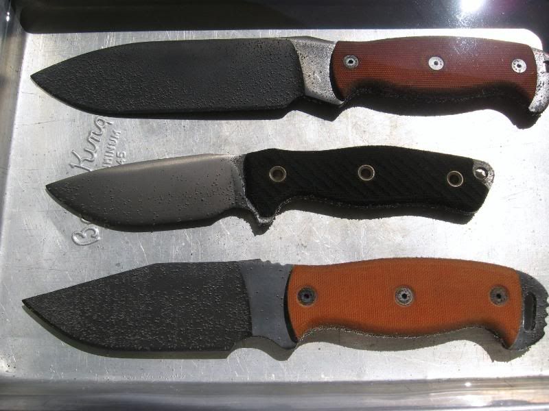

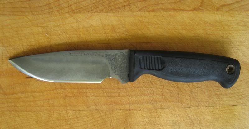

I did some vinegar patinas recently, just for fun.
I just soaked them in vinegar for an hour or so.

The Rangers and Rats seem to take it better. The patina sure shows off the great
sharpening jobs you have done Vic.
