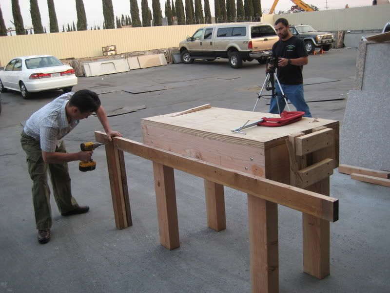

Everyone one of these knives except the top (green) fbm has been convexed. ![[Linked Image from img.photobucket.com]](http://img.photobucket.com/albums/v302/MRpilot/mini%20busse%20meet%203/IMG_7542.jpg) It makes a HUGE difference in chopping. You feel a nice deep bite, instead of it almost bouncing out. Our chopping table. ![[Linked Image from img.photobucket.com]](http://img.photobucket.com/albums/v302/MRpilot/mini%20busse%20meet%202/IMG_6813.jpg) 2x8 ![[Linked Image from img.photobucket.com]](http://img.photobucket.com/albums/v302/MRpilot/mini%20busse%20meet%202/IMG_6851.jpg)
