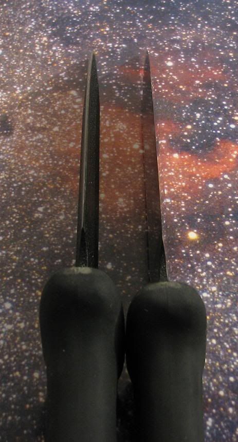

I've created a monster.
The edge is now .010" thick at the closest thing it has to a shoulder, it was .060". Now it's only twice as thick as my thinnest knife, a ZDP-189 Spyderco Caly 3 at .005".
The final edge angle is about 12 degrees per side, a little steeper than I was expecting, but considering the overall thickness of the blade it doesn't surprise me. This is also still the edge formed by polishing the blade (as you'll see later), so I cold potentially knock it down a degree or two with my ceramic stones.
In a way I'm happy with it being slightly on the thick side, once you get around 6-8 degrees per side steel starts to act a little more like tinfoil.

(It comes with a cloaking device too!)

Here's a few shots with my other stripped knife.

Last but not least, I got some macro stuff.
I did a bunch of the rough polishing with an orbital sander (which is now one of my best friends). You can see some of the loopy scratch patterns.
I went straight from 80 grit belt to polishing by hand, and it shows. I probably should have done a bit of work on the 120 and 220 belts. It'll probably be covered with a dark patina by the end of the summer though, so the finish isn't really a big deal.
[Linked Image from i45.photobucket.com]
And the edge. Again, some of the loopy scratches are still discernible. I'm surprised it shaves so well considering how it looks under close inspection.
