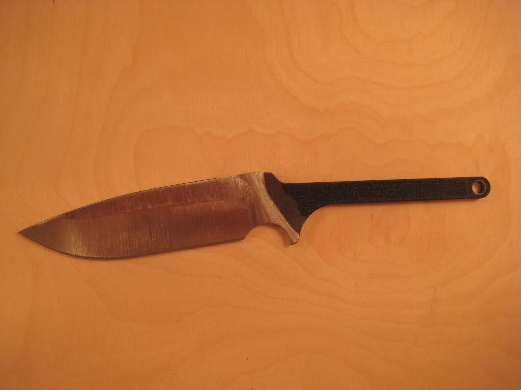

Can one of yall post up a pic of the Scrapper 5
without the handle? An x-ray pic would be fine.
Ive got a rampless, round choiled,S-5 kinda itching
to be modded a little more..

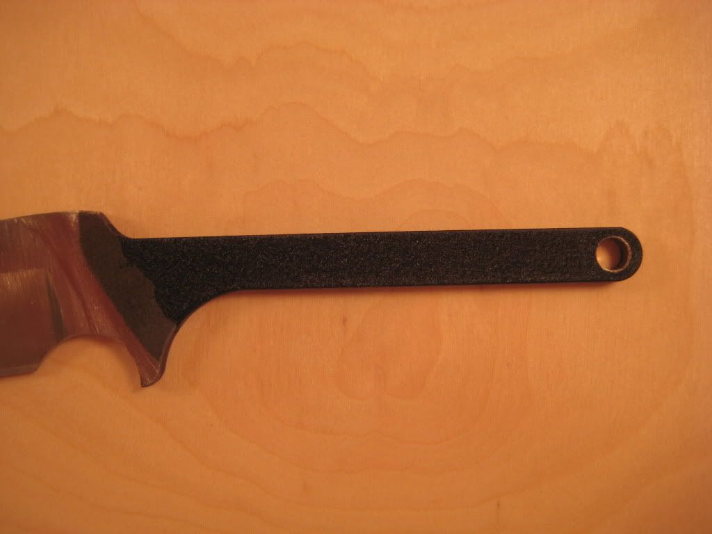

Here you go:
I had already done a fair amount of grinding and modifying on my S5CG prior to thinking about taking process pics. I actually had been trying to do the S5 modifications without removing the handle and decided to go ahead and remove the handle so I could get better results around the ricasso. The ramp had already been rough ground off and the choil has been rough ground at this point. But, the tang was never modified. I did re-grind the ricasso after removing the handle to smooth that area. I left most of the coating on the tang when I re-attached the handle.

Since the Res-C Mudder Handles are standardized, I would be pretty confident that all mudder handled tangs look like above.
Similarly, since the small Res-C handles are standardized, I would be confident all tangs to fit the small Res-C handles would be the same. Notice the slight curve in the small Res-C handle tangs vs. the straight tangs on the mudders.
