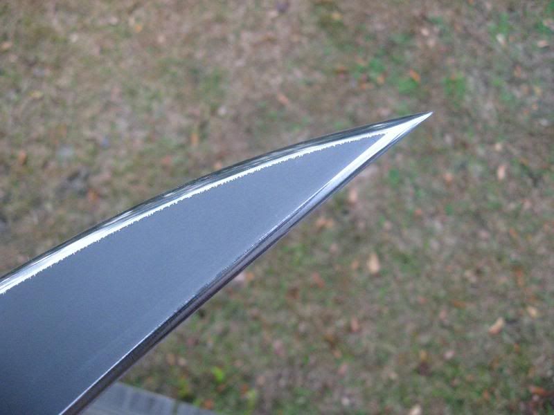

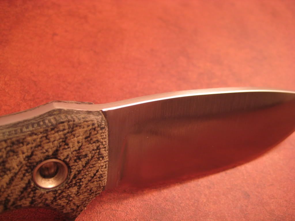

I LOVE a good sharp well profiled convex edge from the factory!!!

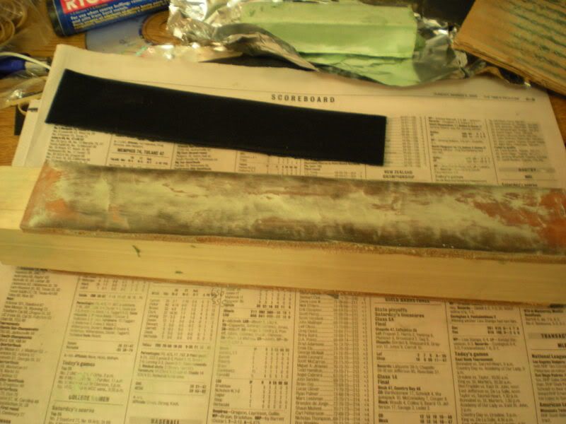

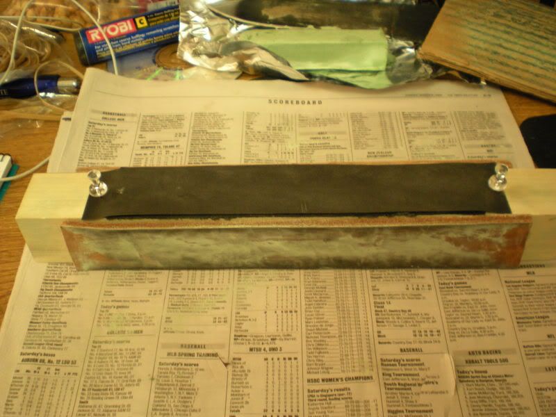

In regards to "stropping" on cardboard. For hair shaving sharp, stropping is the key. I use a belt sander for mainly getting the profile set. Then depending on the knife, I might do a number of different methods to finish the edge - including stropping to get hair shaving sharp.
Most factory knives including Busse and kin come with a "functional" cutting edge. But, most any edge can be improved with a good profile and stropping.
When profiling an edge, you need to keep in mind what you are using the knife for. If it is going to be used for heavy chopping and such, the angle needs to be more obtuse to help prevent edge chipping or easy edge rolling.
If the knife is only for cutting, you can take the profile a little narrower. Different types of steel and different levels of steel hardness handle abilities for narrow profiles differently as well - So, often knowledge of steel AND experimenting is required.
If the knife is for chopping, I don't feel it is worth the time and effort for much stropping. But, if you have a good smaller task/chore knife that you use primarily for cutting tasks, a stropped edge to hair popping sharp is an addictive joy.

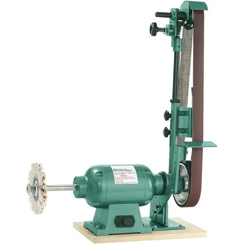

I typically profile with my knives with the belt sander and about 220 grit belts. I have been wanting to get other grits and a leather belt for my sander, but I have been wanting to upgrade my sander and my upgrade will be to different sized belts - so I haven't wanted to spend the money on belts until I get a new belt sander. However, for now, I have been doing pretty darn good with 220 grit on my 1"x30" sander followed by stropping with compound on a leather strop. And then I final strop on med. coarse paper such as cardboard or similar.
I have a couple of differet "bar" type compounds that work VERY well and surprisinbly fast.

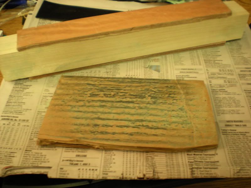

But, to answer the question about cardboard: Yes, Cardboard is Excellent for that final touch. Cardboard or similar rough paper like grocery bag paper or semi-rough post cards, magazine insert cards, some sheet paper or envelopes even if no seem in the way - all work at removing the final little micro burrs on an edge. Stropping with these materials can take the final step from draw cutting paper pretty well to push cutting paper really well!
But, you have to have a "GOOD" edge to begin with. Stropping a bad edge on cardboard isn't going to buy you much.
You can't get an edge profiled or fix a lot of edge work with cardboard. You have to have a pretty good edge already and use cardboard as "Touch up".

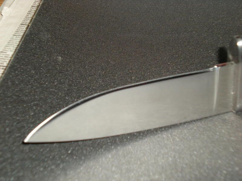

There is a "catch" with convex edges: good convex edges are not "really" compatible with stones and most of the sharpening "jigs" on the market.
Conversely, flat edges are not "really" very compatible with strops (for most people).
But, personally, I am a huge advocate of convex edges. I could write a lot more about convex edges and what I consider advantages, but I would probably double or triple this post and I don't have time for that.
Bottom line: Flat angled blade edges can and do cut well. But, IMO, a good convexed edge is a smoother cutting tool. Full convex blades are my favorite. But, a good convex edge on a flat grind is a reasonably close second.

Stropping with "compounds" on leather is MUCH cheaper in the long run that buying the fine 600 - 2500 grit paper at auto parts stores.
*** Compounds on leather strop (IMO) is also much BETTER than fine grit sandpaper.
A small package of 5 "half" sheets of fine paper costs about $3.00 - $5.00. But, "worse" - the fine grit papers don't last very long. So, they can get expensive fast.
You don't really need to use so many different grits.
I didn't finish in my earlier long post (got side-tracked), but I do a lot of profiling with 220 grit on my belt sander and have had GREAT success just using two different compounds on strop followed by final touch up strop on med. coarse types of paper (similar to cardboard). Hairs will pop.
If doing it all by hand, I would think 220, 320, 400 followed by 1-2 different compounds on strop followed by final touch up on cardboard or similar would result in outstanding edges well beyond what most people achieve with stones.
Most people who use stones don't have a sufficient variety of good stones for good results. The good fine grit water stones are very expensive. I have much easier, faster and better luck than when I have tried stones.
I use the green and black compounds I bought from DLT: Compounds @ DLT
The white is very fine. I haven't used it, but I don't know that I need it either.
The green is the best IMO. It is finer than the black. If just maintaining a good edge, green is probably going to be used most often. But, if using 220 belts or paper, I follow with black prior to green.
Cardboard (or similar paper) after green has been VERY good.

*** Again, said many times, but anybody going down the road to a belt sander needs to "PRACTICE" on cheap blades for a good while before going to a good blade.
If not careful, a belt sander can heat up the blade too much and hurt the temper. But, also, the belts "can" remove material VERY fast on edges. If not careful, you can not only re-profile your edges, but also reshape the entire blade - without experience, that can get ugly and bad very fast. <img src="/ubbthreads/images/graemlins/eek.gif" alt="" />

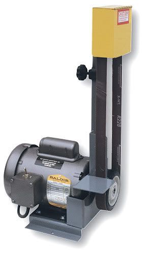

Thanks KG...funny you should mention this the very day my Kalamazoo 1x42 arrived AND I had just printed out the thread by Jerry Hossom. I'm going to take the plunge.
I had (have) concerns about over heating and drawing out the temper and also about the angle of the blade, or I should say edge to the belt. On the straight edge, (choil to beginning of belly) it appears fairly simple, but from the beginning of the belly around to the tip seems a little tricky. As I understand it the handle must be raised as you approach the tip or did I mis-read that? In as much as the blade geometry changes as you approach the tip, (i.e. wider toward the spine) it would seem that some correction is needed in the angle of attack from belly to tip. Is it correct to raise the handle as I described?
Thanks again for all the good stuff!
"And as the moon rises he sits by his fire, thinkin' about women and glasses of beer" JT
Re: Sharpening Thread [Re: tango6] #219489 04/11/08 02:56 AM
Posts: 2,943
KnifeGuy Offline OP
Posts: 2,943
Cool Irony. I wish I had a Kalamazoo delivered .......... a few years ago <img src="/ubbthreads/images/graemlins/rolleyes.gif" alt="" />
Oh well, sometimes using the cheap stuff helps you appreciate the good stuff when you get it. <img src="/ubbthreads/images/graemlins/wink.gif" alt="" /> - Now all I want is a variable speed KMG or Bader. <img src="/ubbthreads/images/graemlins/rolleyes.gif" alt="" />
*** Keep in mind guys, I am trying to help with this info, but I am sharing some things based on what "appears" to be the case in my limited experience. I have been tinkering with my cheapo belt sander for a few years now and I am getting the feel for it. But, I am night a professional knife-maker. I just do lots of modifications for my own personal use.
For the best advice, guys like Jerry Hossom are VERY knowledgable with many years of experience and he does well in trying to help others.
Vic and I are both self pro-claimed "hacks". But, I am sure Vic can jump in here and offer some advice as well.
While on the subjuct of advice:
- Use a mask and eye protection!
If I understand what you are saying and asking and assuming the belt rotation is down where you contact, the yes, you would want to be lifting up on the handle as you go around the belly to the tip.
From my experience, I don't know that you have to have an exact perpendicular angle to the blade, but close is better. What is more important is to have the same consistant motion. When you move the blade around the belt, it is not the end of the world to have an angle or two difference in one part of the blade vs. the other. But, if your movement of the blade around the belt is inconsistant, you will end up with an edge that is visibly not smooth or consistant. It can be made functional. But, the more times you go around trying to equalize the looks and angle of the blade, the more blade edge you will eat up.
AGAIN, you REALLY need to practice on some cheap blade. And ideally practice on a blade size and geometry similar to what you want to sharpen. So, a 3.0" semi-wharnecliffe can be very easy, but also very different from a 5" with lots of belly or a 10" recurve or whatever.
I have generally found the larger blades harder as they require more movement and more ability to stay consistant in your movement over a longer blade. Make sure you have room to move. I have also found that practicing a couple of "dry" movement passes without contact on the belt can help prepare for a fluid consistant movement. - Kind of like a basketball player warming up for a free throw without the ball - ever watch Steve Nash before he shoots a free throw - he practices the motion.
To keep from heating the blade too much - a few tips:
1) The thin edges heat up faster than thick spines. So, especially when sharpening, keep a steady movement and dunk in water after each pass.
2) New fresh belts cut cleaner and faster and seem to generate less heat than older worn belts. (* But, older belts can still have a lot of value.)
3) I am not sure, but it seems to me that coarser grits generate less heat than finer grits (????).
Good luck - practice on cheap blades first!!! <img src="/ubbthreads/images/graemlins/thumbup.gif" alt="" />

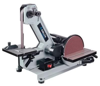

I talked a buddy of mine into getting a VERY fine 1"x42 Delta belt sander that he received a couple of days ago. I just tinkered with it for a few minutes tonight - just starting to show him what his new sweet tool can do. I LOVE his new belt sander WAY more than my old 1"x30".
He doesn't collect knives, but I turned him onto home tinkering and wood-working projects a few years ago. He is finally catching up to me on his tool collection (even passing me <img src="/ubbthreads/images/graemlins/ooo.gif" alt="" />). He won't need to borrow too many tools now. <img src="/ubbthreads/images/graemlins/thumbup.gif" alt="" />
But, check this sweet deal out: Delts 1"x42"
FREE Shipping!!!
At $129.00, most might consider it expensive, but once you get one, start using it, get a good selection of belts and get good with it, you realize it is money WELL spent! <img src="/ubbthreads/images/graemlins/thumbup.gif" alt="" /> <img src="/ubbthreads/images/graemlins/thumbup.gif" alt="" />

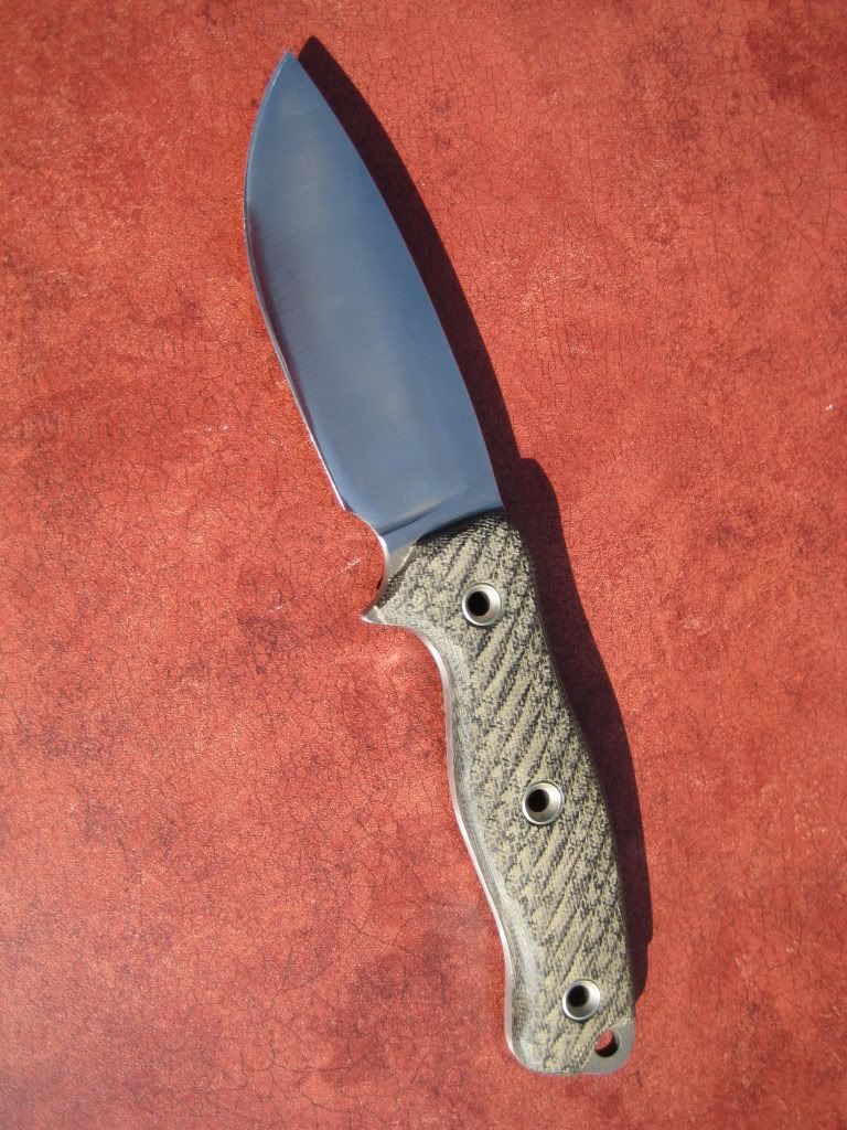

From: #147498 - Mon Nov 19 2007 03:28 PM Stripping the coating
In regards to stripping your blade:
Removing the coating is VERY easy if you use a chemical stripper. There are quite a few brands that will do the job.
I use a gel type from Jasco. You can find a chemical stripper just about anywhere they sell paint: Home Depot, Lowes, Sears, Wal-Mart....
I just use a cheap hobby brush and brush the gel on thick, let sit for about 10-15 minutes till it bubbles and scrape off with a putty knife. Very easy.
If a couple of spots don't come off, put some more stripper on for a few more minutes.
I actually just wash my brush and re-use the brush. If you just brush on what you need, a quart of stripper will probably strip 40 - 60 knives or so (????).
There are lots of posts here, on Swamp Rat Forum, Bladeforums and similar that go into more detail.
So, instead of me retyping a lot of the little details:
See:
Stripping My Howler - Pics of process
Bladeforums - What is the best way to strip Crinkle Coating?
Bladeforums - How does a stripped Swamp Rat knife do?
Vic had a nice post: Tutorial: Stripping & Polishing Pics
......... But, the pics are gone.
The above posts should give you enough info to get you through the simple stripping process and into sanding.
*** But, you should know that as I keep saying: stripping the coating is the easy part - However, Satin finishing the blade is MUCH more time consuming.
"HARD" is a subjective term. With some practice, I could say it isn't terribly hard, but still time consuming.

If you think you will strip multiple knives and/or if you do other home projects AND if you are pretty good with hand tools and safety conscious:

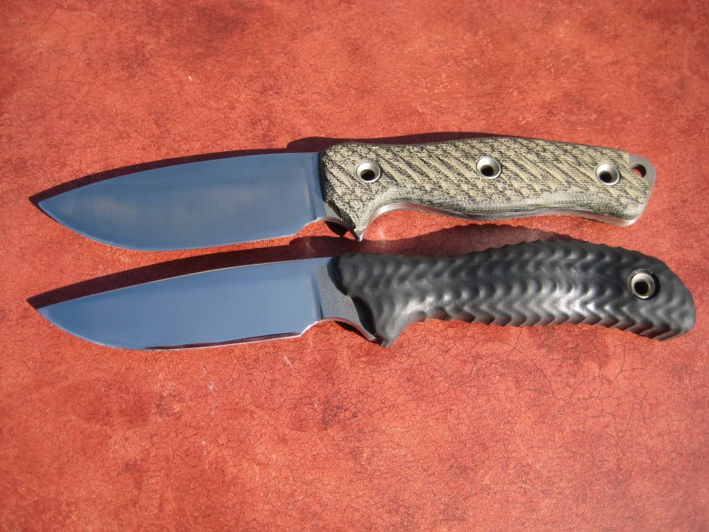

Then, I highly recommend ("Considering") investing in a 1"x30" belt sander.
A belt sander is WAY faster than sanding by hand.
Harbor Freight sells this for $29.99
See: Harbor Freight - Belt Sander
Home Depot, Lowes and Sears usually seem to have a Delta brand or similar for close to $40 - $50.
*** Sanding on sharp knives can be dangerous! Sanding a sharp knife on a fast rotating belt can be more dangerous!
Most knife makers basically use belt sanders to make knives. But, they do most of the work prior to sharpening the blade and sharpen last!
For the record, most professional knife-makers have much better suited belt-sanders with specialized shaped and sized wheels.
But, the 1"x30" sanders can do a LOT and are MUCH cheaper than the professional 2"x48" or 2"x72" models costing $500 to well over $1000.
However, for the fun of it, here are some of the toys the Pros get to play with (maybe someday......):
KMG1 with custom mods (KMG stands for Knife Makers Grinder)
See full link: Caffreyknives.net - KMG with mods
Some people use Bader: Bader grinders
Burr King and many other custom grinders.
Here is a pretty cool "Rotary Platen attachment":
See: BeaumontMetalworks.com - rotary platen
Many of these grinders have variable speed.

However, back to belt sanders, regardless of type of belt sander, it takes some practice!!!
Your first few attempts will likely not be very pretty. I am not just saying this. Many knife-makers have suggested people practice on cheap pieces of steel first to get a feel for using a belt sander.
*** Also, don't over-heat the blades. You can mess up the heat treatment - temper.

You guys out there who haven't yet picked up a belt sander need to head down to your local hardware store and get one. - Or look up Harbor Freight or similar online.
These little 1"x30" belt sanders are not fancy or expensive tools, but they can do a lot! I think I got mine for about $40.00 or so. Belts are usually about $1.50 - $5.00 depending on grit and type. Most of my local stores only carry about 80, 120 and 150 grits. These grits will do a lot of "general" type grinding and yard tool worthy sharpening.
But, fine quality sharpening and polishing will require much finer grits and belts. There are a few good places online for this such as:
Lee Valley
These sanders are great for customizing and/or sharpening knives (and you will need the right belts for sharpening good knives! ). But, I use mine VERY often just for sharpening yard tools and for many other projects around the house.
Dremels are toys by comparison and Dremels cost a lot more. Dremels are good for "Little" tasks. But, they just don't really handle bigger tasks worth a flip. And rotary tools are hard to work with sometimes to get flat, even, mirror or consistant results. The belt sander is MUCH better for almost any knife or tool modification or sharpening - unless on very small parts on a folder or similar - then Dremel.
Belt Sanders at about $40 - $60 are WELL worth the cheap cost! (to me)
However, if you read many of the "How To" threads over on Bladeforums and Knifeforums, they will usually tell you to practice on some cheap knives first to get the feel for it. I will strongly concure with this as I am sure Vic will as well.
This is not a complicated tool to use by any means, but it does have a learning curve for feel and touch - when you want a nice looking finish.
A penetrator tip really is a very easy modification even without much experience... although, I would still recommend a few minutes of practice on something cheap. Be careful not to over grind the tip as you will mess up your point. And make sure the angles are what you want and mirrored (duplicated in reverse on opposite side). Other than that, pretty simple.
Reprofiling isn't too difficult. But, without some practice, you can end up with some ugly results. It does take a little practice to get the angles right and movement of the knife across the belt smoothly and evenly. After you get the hang of it, it is reasonably easy.
There are other more complicated things to grind on a knife. Grinding the flat areas of a CG knife to get rid of pits, but not mess up the shape of the knife and not damage the handle is a lot trickier than a penetrator tip.
It is good to know the limitations of a belt sander too. They can contour some handles, but that takes a fair amount of practice with a belt and belts are hard to get to make certain contours. Sometimes other tools are needed.
This link has some good belt-sanding/grinding tips: Grinder Tips
I like the last one.
But, I can add a few:
- Wear eye protection
- Don't let the blades get too hot (* I don't personally let my blades get so hot I can't hold them at their hottest spots)
- Watch out for the static build-up! - I have to ground myself as I have very strong and jumpy reflexes - which is not good with a fast rotating tool and a sharp blade! Most of the time I don't have any problems. I guess certain types of weather might influence static more (????). I mention this as better to be prepared than sorry. Again, most of the time, it is not a problem. But, every now and then you might build up some static and get a light to a good shock. I generally get zapped from the metal parts of the sander like the work-top. Being shocked is my least favorite part of this tool. Luckily, it isn't a constant problem. But, somedays when you aren't expecting it....
- Learn how to use the platten for flat grinds - a slack belt will not do a flat grind. I like a lot of parts of knives convexed. But, some things are better flat!
- Listen for popping noises. - Usually means something is wrong with your belt. Turn the grinder off. A slightly damaged belt will often pop very quickly after. A belt popping in your face is very unsettling. A belt popping when you have a sharp blade on it is worse. Platten grinding is noticable rougher on belts.
- Don't breath the dust! It is my understanding that certain woods are toxic and micarta is very unhealthy to toxic. I try to wear a mask. I hate masks, but I hate how my lungs feel after it is filled with crap even more. If the weather is nice, set up your grinder outside and hook up a fan. .... Unfortunately, Vic and I have bad Mosquitos!!! Little Bastards! I hate Houston's humidity, but the mosquitos are even more annoying to me. - Fix those two things and Houston is decent enough. - except I would prefer to have some nice mountains in the scenery and near enough to play in. (sorry - tangents).
- Belt grinders make a mess.... just so you know.
I am sure there are other good tips, but I don't want to make this sound to intimidating or complicating. These belt grinders aren't much more complicated to use than a drill or power saw. I would say it is not as dangerous as a power saw for sure. But, it takes a little more practice because of the much more "Freehand" nature of using a belt sander. And you always have to keep in mind you have a sharp blade in your hand that you don't want to get caught and thrown by a fast rotating tool.
So, again, I recommend some practice on cheap stuff first. - Probably best to practice on some "DULL" stuff first as well. <img src="/ubbthreads/images/graemlins/wink.gif" alt="" />

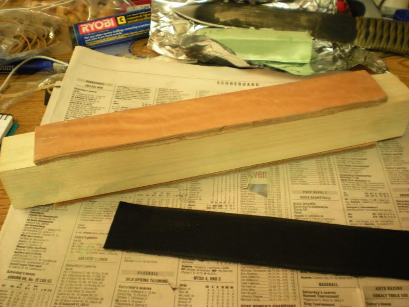

I recently built myself a new strop bat (with some leather scraps help from a fellow forum buddy here - Thanks Brian).
My strap bat is pretty big at about 22.5" long and with the strop surface area about 13" x 3.1875".
Honestly, the handle doesn't realy have much value. I could have left it off. But, I like the size of the surface area. There are a lot of strops out there with a small width of 1.5" - 2.0". They work, but I like the larger area for larger knives.
I just glued and clamped together some scrap pieces of Kempas hardwood flooring leftover from re-flooring part of my house. I used some brad nails and screws in some hidden places as I tend to over-build my projects. <img src="/ubbthreads/images/graemlins/rolleyes.gif" alt="" />
The slats are solid hardwood and were nice and flat. (* This Kempas is some VERY HARD / TOUGH heavy duty wood! <img src="/ubbthreads/images/graemlins/ooo.gif" alt="" /> )
It doesn't need to have different levels and bevels and such, but.... <img src="/ubbthreads/images/graemlins/blush.gif" alt="" /> :
With compound (needs some heat and smoothing <img src="/ubbthreads/images/graemlins/smirk.gif" alt="" />):
I picked up my compounds from DLT Trading Co
The Black does about 90% of the work with the green just doing the final touch up to the edge.
In most cases, the key is to not push down on the knife and just let the weight of the knife be enough - unless the blade is very light.
If you push down too hard, you cause the abrasive to rise back behind the sharp edge and dull the edge instead of sharpen. It takes patience and time.
There are some pretty good videos on YouTube about stropping.
I still love this video from J. Neilson. J. Neilson uses a power-strop / belt sander method:
Quick & easy knife sharpening - J. Neilson - Notice very little flex in the belts when sharpening.
I currently use my belt sander for just shaping and reprofiling. But, with the 220 grit, I get a bunch of the shaping of the edge done. I still want to upgrade to some better/finer grits and some leather strop belts some day. But, I am holding off for a better quality belt sander still. (some day <img src="/ubbthreads/images/graemlins/frown.gif" alt="" /> <img src="/ubbthreads/images/graemlins/blush.gif" alt="" />)
Since Bark River makes all of their knives with a convex edge, there are a lot of good threads/posts on the Bark River forum (at Knifeforums.com) about stropping.
I like to keep my compound flat on my strop, but I don't like to use my knife to flatten the compound as it will abrade any given part of the knife intentionally or not.
So, I keep a cheap 3" - 4" putty (spackling) blade near my strop to help keep my strop compound level and flat.
Putty knives can be had for $3 - $4 at any hardwear store.
But, any cheap piece of "FLAT" / square edged metal will work.
I also have some metal rulers from Wal-Mart that are about 1.25" wide and good thickness and nice edges for about a $1.00. They could be cut in half or thirds and work VERY well!
Spines of various saw blades should work well such as Reciprocating or Jigsaw blades, old scrap hack-saw blades, etc.
Just any scrap piece of metal that has a pretty good flat square edge that can scrape.
I like to hold the metal blade with both hands on either side of the strop and draw (pull) the blade across the strop at just slightly forward of 90 degrees like you would draw a burnishing or scraping blade across flat wood.
I keep my strop on a pan or lid to catch the crumbs when I do this.
I don't like to mess up my blades or spines of my knives leveling my strop.

I have about an hours worth of videos on sharpening with a belt sander posted here. There might be something useful in there.
BTW, I just picked up one of those KMG's <img src="/ubbthreads/images/graemlins/laugh.gif" alt="" />
Those are VERY good vids Brian - You Da Man. <img src="/ubbthreads/images/graemlins/bowdown.gif" alt="" /> <img src="/ubbthreads/images/graemlins/bowdown.gif" alt="" /> <img src="/ubbthreads/images/graemlins/thumbup.gif" alt="" />
We need vids of that KMG in action!!! <img src="/ubbthreads/images/graemlins/ooo.gif" alt="" /> <img src="/ubbthreads/images/graemlins/ooo.gif" alt="" /> <img src="/ubbthreads/images/graemlins/crossfingers.gif" alt="" />

Now I just need a Kalamazoo or a KMG. <img src="/ubbthreads/images/graemlins/blush.gif" alt="" /> <img src="/ubbthreads/images/graemlins/crossfingers.gif" alt="" /> - some day.....

This seems to be a good price, the least expensive I've found thus far, for a new Kalamazoo:
http://www.knifekits.com/vcom/product_info.php?cPath=49_115_207&products_id=309
crpoc,
that is probably the best price I have seen on a Kalamazoo.
It has been a little while since I bought my KG, but I swear I paid $199 for it. I bought it local and Production Tool Supply. There was one near where I worked and I didn't have to pay shipping. I am not sure how much shipping is on them, but it can't be tool cheap.
Long way of saying, you might want to look in to the more "commercial" tool supply companies (like Production Tool).

Hey Knifeguy,
I was doing more reading last night from your posts and links from your posts, and I'm seriously considering a belt sander. With that Delta sander and even a handful of belts, I can probably get into the game under $200. For some reason, I'm REALLY having trouble getting a decent edge on my SOD even though I've been sharpening knives on my bench stone for years. It's just so big and thick, and I think that I need some powered help. <img src="/ubbthreads/images/graemlins/confused.gif" alt="" />
Several folks made the comment about the Delta being high speed. Do you have any concerns over this? Can you still use it but possibly go down in grit size (say 500 rather than 250), so your blade doesn't heat up as fast?
I'd appreciate any thoughts that you can throw my way.
Nick
Nick,
For $200, you can “get into the game” very well. Amazon sells the Delta SA180 for about $114 with free shipping last I checked (it changes…). A good leather belt will probably run about $25 - $35. A handful of various grits on decent quality belts and a couple of abrasive compounds will take you to about $200 or so. With that set-up, you will be able to do a LOT!
But, practice on some cheap junker knives at first is always highly recommended.
I am a big advocate of using a belt sander for sharpening and “reprofiling” my edges.
I don’t have the SOD, but I have and have had many other Busse and kin knives.
Busse and kin knives have a mentality of shipping their sharpened edges fairly obtuse. Since Busse and kin have developed such a reputation for hard use/abuse knives and since there is a fair amount of the people who use Busse and kin knives who want their knives to show no or very little edge damage or edge deformation even when pounding their Busse and kin knives into cinder blocks. Over the years, I have seen quite a few posts from people who took their new Busse and kin knife of whatever steel out and beat on harder than steel materials and then posted with surprise on how their Busse “failed” (in the owners mind) because it had a little ding or roll. The reality is that INFI, SR-77, SR-101 are all very tough, but they will still ding and roll with certain abuse even with a very thick obtuse edge because there are many other materials that have a higher hardness including other steels or various rocks and minerals in nature. But, Busse steel has a very good reputation for not chipping out. Although, there have been a few exceptions. In any event, those thick obtuse edges are tough edges, but still just don’t make great slice cutting edges.
You “Can” make an obtuse angle “sharp”. Many shearing machines have close to 90 degree angles. But, while “sharp” edges can accomplish many types of cutting tasks, obtuse edges don’t make the best slice cutting edges. Finer thinner angles will slice through material easier.
With knife steels there are compromises. If you want a thin slicer, it won’t be as tough. If you want Uber-tough, you tend to have to compromise in some of the slicing potential. SR-77 can be re-profiled to have a much thinner edge than typically ships from the factory. And this thinner edge will slice better and still be “reasonably” tough. But, it will roll and deform a little easier. There are a lot of factors to consider when reprofiling a blades edge. But, basically, if you are doing your own knives and do it often enough with lots of knife use, you get a feel for what type of edge profile you like and what is best for your uses.
If you beat the snot out of certain knives, you should probably consider leaving the bevels on those knives a little thicker. If you have certain knives with harder steel that you only use for dedicated slicing, you can typically make those bevels more acute to optimize slicing. Just know that the thicker edges won’t slice as well and the thinner ones will get damaged easier if abused.
In either case, a convexed edge as you would develop by using a belt sander, will cut very well. I personally prefer a convexed edge on most of my knife edges and especially my field use knives. I think a good convex edge can offer a good balance of edge toughness with good slicing ability. Some fine slicing knives might be slightly better served with an acute flat edge grind, but for most any real world use – especially field use and for larger knives such as the SOD, I consider a convex edge ideal. But, opinions vary.
With practice, the right belt sander and the right belts/grits/abrasives, a belt sander can be MUCH faster at reprofiling and sharpening knives.
The general public has it fixed in their heads for centuries on using stones for sharpening. For those who insist on using stones and want a fixed angle, there are some great sharpening jigs on the market. Some people have relearned the art of stropping. I built and still use my strop a lot. I can use my strop easier inside the house. And there are some great ideas out there for creating pack-worthy mini strop kits for field use, hunting, camping, survival, etc.
I generally only use my stop for fine tuning and only because I still haven’t yet upgraded my belt sander to what I want. And since I haven’t upgraded my belt sander, I don’t want to waste money on certain belts for my current belt sander/grinder. I have been dying to get some quality leather belts for power stropping on my belt sander. If Busse and kin would stop taking most all of my money, I might be able to buy an upgraded belt sander. While a 1”x30” is cheap and can do a LOT, I still recommend saving your pennies for a nice Delta SA180 or better. (Check Amazon.com)
Nick
My concern is not heat build-up as I have a good feel for that and I don’t think it takes much practice to get a feel for. Just knowing about how to keep an eye on heat build-up and following through with a couple of simple practices, makes heat build-up reasonably easy to keep in check.
My much bigger concern is “Control”. I want clean lines and don’t want goofed up spots on my blade.
If you slightly dig a belt into a corner of your blade just slightly wrong, it can take a LOT of balancing and steel removal to make a blade look decent again. It is a lot easier to avoid messing up your blade by just edge sharpening. But, I have used my machine for lots of significant modifications on many types of knives including folders. Little details and even big grind changes can both be hard to get right with cheap equipment.
In regards to heat build-up: coarser grits don't necessarily heat the blades as fast as finer grits. I can understand why you might think this.
Coarse grits obviously remove more material and much faster and they can develop heat quite rapidly, but the tendency for most people if you use a finer grit is to hold the blade on the finer grit longer and harder to try to remove more material. Doing so will develop heat VERY fast. I think it is common for many to think that if you are removing a lot of material, you are generating more heat vs. not removing much material doesn’t generate much heat. But, this is not how it works.
Coarser grits can literally “Cut” off the steel with less friction. Finer grits have more and more contact and more and more micro-abrasion “Friction” that generates a lot of heat (sometimes very fast) even if not removing so much material. Most people wouldn’t think a buffing wheel with compound would generate much heat – they would be VERY wrong.
Probably, the two most common things to watch out for – especially for beginners are:
1. Not to let the heat build up to much and damage temper. But, just knowing to watch out for this makes this fairly easy to prevent. Knowing to watch for it, and using a water dunk.
2. Destroying nice grind lines. This just takes a lot of practice, familiarity with grits, how to angle and move your blade, etc. But, coarser grits can and will do much more damage faster if you mis-align your blade or otherwise grind it improperly. In many cases, you can get good enough to deal with a higher speed machine just by getting good at how to angle and move the blade with the right pressure in concert with a given machine’s speed. But, in many cases, variable speed would be a very nice option.
For me, I would probably be fine in most cases for 90% of my grinding with a Delta’s full speed. My current grinder only has one speed. But, I have talked a buddy into the SA180 and used it a bit. It does seem faster. But, it also seems much easier to control. To me, to keep my grind lines smooth and straight, the control factor out-weighs speed.
My cheapo Delta 1”x30” has too much belt movement and too much belt curvature. I have accomplished a lot with it and with a lot of experience and familiarity with it, I have produced some decent results. But, I am VERY confident, I could produce even better results faster and with much more ease with a better tool than my cheapo 1”x30”. And I am confident the much higher end Delta SA180 is about 4-6 times better quality than my cheapo Delta.
However, even with the higher speed of a Delta SA180 being fine for me in most cases, if I want to “hone” with very fine grits and leather belts, I think slower speeds offer even more control.
But, I have not seen variable speed belt sanders for much less than $2,000.
I don’t have a Delta SA180 (yet???), but if and when I get one, I might be interested in trying one of a couple of attempts I have seen to modify belt speeds by adding multiple sized pulley’s. See:
Delta SA180 Belt Pulley modifications
Regardless of grit, I recommend a few things:
1. Keep in mind that the heat build-up between a belt grinder and knife steel is through friction and more importantly “AT” the point of friction. In most cases, people are doing most of their grinding “AT” the thinnest part of the blade (the edge). A thicker part of steel can “dissipate” heat. But, a thinner part cannot so easily. If you feel heat in the upper thicker parts of the blade like the spine, the thin edge that you are creating the heat at would have been MANY times hotter. Which brings the next point:
2. Always keep a bowl of water dunk close to your grinder. You will have to practice to know how and where is the best/ideal place to keep you water dunk. *Don’t use glass - I actually used an old very thick glass vase once because it was handy. I thought it was solid and thick at about ¼” thick glass and it was deep enough for my blade, after about 10 dunks, the glass cracked and then fell apart making a big mess on my workbench and shop. The dunk bowl needs to hold water at least as long as the blade and some extra inches of water can be handy as well. Sometimes, I will reshape choils, thumb ramps and such and will dunk a portion of the handle a few inches beyond what I am grinding. Ambient temperature water will cool the blade down VERY fast – within often within a second or two and many times faster than air cooling. When I first started using my belt sander, I didn’t always have a dunk handy. Even then as now, I like to keep the blades cool enough where I can tough and hold any part of the blade – especially at the areas I am grinding. Waiting for a blade to air cool so you can keep grinding takes WAY longer than a dunk. Especially for beginners (until you get a good feel for how various belts build up heat and how heat dissipates on various blades), I recommend dunking after every 1-3 passes or so. With practice, you will get a feel for friction vs. heat build-up and when to dunk.
3. Don’t hold any blade stagnant against the belt – most any grit can “burn” into any blade if held stagnant. If you “Burn” the blade, you have most likely damaged the heat treatment/temper to some degree. A “burn” mark will often be some sort of discoloration in the steel – black, blue, orange, etc. depending on the type of steel and severity of the burn. If burned (damaged temper), the blade can *Plus, holding a blade stagnant against a belt will ruin your grind line. If you have a bad ding or roll in an edge, you will still have to grind it out across the whole length of the blade by running the full length of a blade across the belt. In some cases, you can feather/taper a blade on and off of the belt, but that requires more practice and can still mess up your grind lines if you don’t have a lot of experience. By keeping a blade moving, you don’t generate “spot” heat and you help the heat distribute and dissipate more evenly.
4. I am sure there are more things to recommend (?????), but practice is best.
As has been said in many of the previous posts about using a belt sander/grinder for the first time, start with a CHEAP practice blade. Further, I would recommend trying to start with various size and shaped cheap practice blades to familiarize yourself with blades comparable to what you will actually be wanting to work on. Flatter edges are easier to work on. Curvier blades with lots of belly and recurves are trickier. 3” – 5” blades are easier, larger 7.5” + blades require steadier movements. Small little blades can either be easy or hard (?????).
Depending on what you are doing, sometimes it would still be advised to use the coarser grits – at least to a point.
Below, I will attempt to break down how “I” use the various sanding grits. *** But, keep in mind that how they are used can vary depending on type and hardness of steel, size and shape of knife, your experience level, your belt sander/grinder and it’s speeds, etc…
The common belt grits are:
40 - VERY coarse - for fast material removal - best for serious blade shaping, knife “Making”, fast reprofiling and similar – One should probably be pretty experienced before using this grit as a blades “shape” can be VERY quickly altered and made to look like a mess if you don’t have a feel for it. Great for quickly taking heavy dings out of machetes, axes/hatchets and such before progressing to finer grits. I don’t often use this grit for finer quality knives.
80 - Pretty coarse - still pretty fast material removal - still good for blade shaping and fast reprofiling, but offers more control for most novices compared to 40 grit. This grit will become a must have grit for heavy edge re-profiling or ding fixing and is still a good grit for fixing heavy dings in machetes and such. But, 80 grit can still mess up a blade fast if not experienced. So, I would still recommend starting with 120 – 220 on nicer knives for novices.
120 – Fairly coarse – moderate material removal – still a grit for shaping and reprofiling. Not really for sharpening.
150 – Fairly coarse – very similar to 120, but slightly finer
220 – Medium grit – can slowly/slightly reprofile and quickly sharpen, but not a keen edge (IMO)
320, 400, 600, 15 micron, 9 micronblack, green, white pink polishing compounds, all perform varying levels of sharpening and polishing.
For a good source for Belts see:
Lee Valley Belts
Jantz Knife Supply
Texas Knife Supply - Sanding Belts
Pop's Knife Supply - Sanding Belts
I think it was Snotpig who had good luck with the premium belts from here:
McMaster-Carr - Sanding belts
There are some other belts sources and types of belts I have seen recommended, but I wouldn’t be the best source for advice. I actually had some other links at one time, but can’t find them.
When using your belt sander for reprofiling and coarser grit belts, Vic, myself, Mike Stewart and many others will grind the edge into the rotation of the belt. This technique allows you to better see the edge as you are grinding and results in a better edge grind and/or edge profile.
I believe Vic and Mike actually do a lot of sharpening that way to. But, it gets trickier with finer grits (which have thinner paper).
The thicker heavier grits and belts are much more forgiving to an edge. I have yet to cut through a heavy coarse grit belt. But, the thinner belts can be cut just a little easier than I like - especially, certain cheaper belts or well worn belts. I don’t think the belts cut so easily just by the blade’s edge cutting into the belt at a perpendicular angle. I think what happens is if the blades edge is just slightly angled and catches the corner, it slices through the belt in a fraction of a second – Basically, the belt pops and flys around the wheels a bit - VERY fast and fairly unsettling. I haven’t been hit by a belt or hurt, but I suppose it could do some damage. Also, when a belt is worn and/or frayed, I think they are more prone to being snagged by a blade’s edge. Or certain cheaper belts have a lesser quality lap joint that can be snagged by a blades edge.
Maybe Vic can chime in and add more input. BrianA is also quite skilled and knowledgeable about belt sanding as some others around here. But, hopefully, I at least addressed your question about heat vs. grits and speed.

Like this: JRE Industries - Strop Bats
I don’t have one of JRE’s strop bats. But, I have dealt with Dan at JRE. He seemed very helpful and friendly to deal with to me. And I have seen some posts in regards to others saying JRE’s strop belt was well made and a good design.
JRE’s price of $35 for a 4-sided and pre-loaded strop bat with (I am sure) good quality strop leather on a Red Oak bat, seems like a VERY good price/deal.
Notice JRE states: “We can make The Strop Bat any size you like. Custom size Strop Bats are NOT a problem! Just call us or email us with your specifications.”
Personally, I like a little larger strop bat. My strops leather surface area is about 13" x 3.1875" – But, mine is probably larger than needed.
I still like a surface area larger than 1.5" width as it helps with larger knives (IMO). But, in all fairness, you could easily strop a 10” blade on the “9 - 10 Inches long by 1.5 inches wide” like the strop surface area of JRE’s strop. The length is definitely not a problem.
But, personally, I would probably still opt up to a 2.5” wide strop or at least 2” wide which would still be plenty good and better/more versatile than 1.2" wide.
I don’t think most people would appreciate much gain in going up to 3” wide over 2.5” width. But, I think 2" has some advantages over 1.5" and 2.5" has some advantages over 2.0".
I don’t know what Dan charges for the custom sizing. But, I am pretty sure the prices would be fair and reasonable.
I ordered a sheath for my Bravo 1 from JRE that is nowhere near as nice as some of Jeff’s (Rainwalker) sheaths. I would rather own one of Jeff’s sheaths, but this was a time crunch situation and the JRE sheath was inexpensive, very functional and good quality for the money. He actually didn’t have the sheath in stock, but he made it up the night I ordered it and I had the sheath like 2-3 days later – VERY fast. I don’t believe that type of speed is normal – especially for out of stock items, but if anything, I would say that Dan at JRE obviously tries to work with his customers to help them get what they want.
For the record, convex sharpening by hand on a strop is still slow and tedious - especially if significant reprofiling is needed. But, the great thing about having a manual (convex technique )strop is for touching up. A strop bat is a great compliment to a belt sanding technique. - *One doesn't mess up the other.
With the right belts on a belt sander, you can get a VERY fine hair splitting edge and have no "need" for a strop. But, having and knowing how to use the strop for touch ups can be good for those times when you don't want to go outside, into your garage/shop, etc. to crank up the belt sander.... even if it would still be way faster to go to the shop/garage and use the belt sander.
Sometimes I will strop a knife or two while watching TV or something. But, also, some people might want a portable "field" strop kit. - something that would mess up fixed angle jig sharpened edges.

But, there are some similar fine grit belts or even better, leather belts loaded with fine honing compounds.
I believe I have posted some info and links somewhere above with more info about honing compounds. These are essential for decent results with a leather strop (IMO).
Some common compounds are black, green, white and pink.
There doesn't seem to be a clear consensus on what grits they are. But, to me (and I am generally guessing here!!!):
Black seems to be around 400-600 grit (???)
Green seems to be around 800-1000 (???)
White seems to be around 1200-2000 (????)
Pink seems to be around 2500 +/- (????)
Again, just guessing bases on what I have seen. But, on a power tool like a belt sander, each grit will provide much faster results than compared to a manual strop.
**** Good quality belts make a big difference. The cheap ones from the hardware store "will" get a lot done. But, once you use good quality belts designed for use on "hardened" steel, you will notice a big difference.
You should know that most of the belts sold at hardware stores are intended for use on "wood". However, in a pinch, they will still work on knives. Just not as efficiently.
**** One little tip I believe I read on some other forum posted by a knife-maker (????). I can't remember who or when, but I have tried it with great results:
If you don't have a fine grit/micron belt, try taking an older belt, turn it inside-out and use the back cloth mesh of the belt to sharpen with. I did not have much success with the backing dry. But, I put some white compound on the back (green or black would work as well - just green and black are more coarse). The white compound on the backing/mesh of an old belt will give you a mirror polish. The right light touch will give you hair-whittling edges! <img src="/ubbthreads/images/graemlins/wink.gif" alt="" /> <img src="/ubbthreads/images/graemlins/thumbup.gif" alt="" />

well, i suck at sharpening SR77 steel. I'm used to sharpening carbon steel. I can get any of my other knives hair popping sharp, but this SOD is stumping me. Part of it i think, is i want hair popping sharp, but i use the knife as a chopper so maybe a more blunt edge is better.
JUNKYARD DAWG #86
Re: Sharpening Thread [Re: Bushman5] #219539 02/12/09 05:04 PM
My SODLE came reasonably sharp, but I like a more acute convex edge. This edge is still plenty strong for chopping wood (not concrete) and slices quite well. I use a belt sander. It can be done. We have the technology.

Delta discontinued the SA180! There isn't another 1x42 belt sander in town. Harbor Freight has the 1x30 and that might be what I'm going to get.
Re: Sharpening Thread [Re: imaginefj] #219555 02/14/09 09:08 PM
I hope 1" x 42" belts will still be around. I just recently got my Delta. Practicing on machetes with the 1x30 was how I learned to grind. I finished up a machete for a dog today. He wanted the swedge sharpened. It finally stopped raining about an hour ago, so I worked on the swedge in the remaining light of the day. Here it is unsharpened.
And finished.

I thought that was because they were planning on a new model. At least that was what my local dealer told me.
Sure there is. Kalamazoo Industries. You won't find out at Home Depot, but you can find them at places like Product Tool Supply.
I think 1x42 belts will be around for a long time.

Well I think my EZE Sharp might be sold so I am looking at the belt sanders locally. I believe lowes has the Deltas. There are several belt sanders out at a shop of my dads but it is a decent drive and I would like to have a decent set up at home instead of driving out there all the time.
I've cleared a spot in the garage so I'm half way there.
Thank all of you guys for taking the time to post this great info.
Okay, the EZE Sharp was great but now its sold. So I called Lowes and they no longer carry the Delta 1 x 42 belt sanders. I called Home Depot and they had 4 x 3? belt sanders. Harbour Freight doesn't carry anything I think I am going to want. Sears has some belt sanders? Anyone know about them?
S.H., Glad that the EZE Sharp was able to give you a couple years of good use. <img src="/ubbthreads/images/graemlins/thumbup.gif" alt="" /> But, the belt sander system is so much faster and easier - if you have a decent belt grinder and good quality belts - then "after" you get past the learning curve. <img src="/ubbthreads/images/graemlins/thumbup.gif" alt="" />
All of the Lowes and Home Depot's around me have quit carrying "Any" bench-top belt sanders quite a few months ago now. <img src="/ubbthreads/images/graemlins/confused.gif" alt="" />
I haven't seen any "good" options (for knife modifying/sharpening uses!) at my local Sears either. <img src="/ubbthreads/images/graemlins/confused.gif" alt="" />
I looked at Sears.com.
They have a Craftsman 2"x42 for about $129.99. While at a quick glance, a 2"x42" such as that Craftsman might seem like a good option at a good price, I can't recommend it for knives as 2"x42" is HARD to find worthy selection of belts for. <img src="/ubbthreads/images/graemlins/confused.gif" alt="" /> <img src="/ubbthreads/images/graemlins/frown.gif" alt="" /> I actually have NOT come across any of the good belts for 2"x42". 2"x48" is a size with a few belt options.
******* Belt size is a VERY worthy consideration when considering which belt sander to choose for knife modifications and sharpening. The best choice by far for belt selection is 2"x72" belts. But, this belt size is cost prohibitive for most people as 2"x72" machines tend to be very expensive. See more below.
The second best choice for good belt selections for knives is 1"x42".
1"x30" is a distant 3rd. VERY few options in 1"x48" that I have come across.
Texas Knife Supply offers a proprietary sized 2.5"x48" belt sander that appears to be a decent machine. But, I have not seen 2.5"x48" belts anywhere except at Texas Knife Supply. I assume Texas Knife Supply has the belts made for their machine. (??????) Considering the unique size, I consider the machine a potential dead-end if Texas Knife Supply decides to quit carrying belts.
However, for those interested, see: Texas Knife Supply Belt Sander
Sears also shows Wilton brands. Sears shows a Wilton 1"x42" model #4002 that looks VERY much like the Delta SA180. *** I wouldn't be at all surprised if they are exactly the same or made in the same place with only very subtle variations. But, the Wilton 1"x42" sells for over $300 vs. about $130 or so for the Delta SA180. So, I would have to recommend searching for a Delta SA180.
Sears also shows a Wilton 2"x42" that again seems like a better value and more machine for the money vs. the Wilton 1"x42", but again, you just can't find a worthwhile selection of belts suitable for working metal in 2"x42". That belt size is just going to offer belts more suitable for woodworking. Although, while not nearly as good as quality belts from online knife-making sources.
Sears and many other hardware stores often offer 4"x36" or 6"x48" belt sanders and such, but these wide belt machines are not generally very versatile for knife-making and again, you just won't find belts suitable for sharpening. I have one I have owned for years for woodworking. They might have some value in flattening out spines or helping to shape handles, but they are just not the best option for most general purpose knife modifications and sharpening.
I assume some local Sears hardware stores "might" possibly carry options other than what is shown online (??????), but based on what is shown online, I don't think Sears has any worthwhile options for general knife modifying and definitely not the best choices for knife sharpening.
There are still a few good belt sander options online through other retailers though. <img src="/ubbthreads/images/graemlins/thumbup.gif" alt="" />
As Vic says, the little 1"x30" Harbor Freight is a decent / Cheap option. And there are a few sources for decent 1"x30" belts suitable for sharpening and modifying knives.
But, again, the best selection for belts is going to be in 2"x72" and 1"x42".
2"x72" belt sanders are often VERY nice, much higher quality build, very heavy and very expensive. The machining industry uses that size as a common standard size. So, lots of options, but generally because of being geared to the commercial use industry, the 2"x72" machines tend to be too expensive for most of us knife enthusiasts to justify. Variable speed is an option I wish I could afford that is often available on many 2"x72" sanders. But, most of these machines cost around $2,000 - $2,800 or so. <img src="/ubbthreads/images/graemlins/banghead.gif" alt="" />
If you don't want to spend, $2,000+ for a belt sander, Grizzly sells probably easily the best "economy" 2"x72" belt sander - Model # G1015 combo 2"x72" belt sander with a buffer on the other side. But, most will probably consider $469.00 shipped ($395.00 + $74.00 shipping) pretty high still.
Grizzly G1015 Belt Sander
The Grizzly G1015 is a very worthy machine and used by MANY knife-makers. The machine also has quite a few modifications and aftermarket parts posted around the web to help make it perform even better for knife-making/modifying, etc.
********* For anyone who uses the Grizzly G1015 or any machine with a buffer on knives, be VERY careful with buffers and knives!!!!! Most knife-makers who know about buffing will tell you that a buffer is the most dangerous tool around knives. The Grizzly has a 14 amp motor at about 1 H.P. - it is pretty stong and heavy duty - like a good table saw motor. Buffing wheels have a serious history of grabbing blades and throwing them - often resulting in serious injury. <img src="/ubbthreads/images/graemlins/shocked.gif" alt="" />
As Brian mentioned, Kalamazoo is another company providing a Great option for belt sanders for knife making and modifying. The 1SM is a quality built machine with 1"x42" belts.
Knifekits.com sells the Kalamazoo 1SM for about $230. See: Knifekits.com Kalamazoo Belt Sander and attachments
Some of the attachments available for the Kalamazoo are pretty inticing for modifications. The Swing plate and horizontal finishing attachment would be great options for modifying handles, choils, folders and MUCH more. But, $230 for the sander and another $200+ for attachments might be a bit much for most people (?????)
Although, for just the base sander, $230 will get you a great basic sander still. <img src="/ubbthreads/images/graemlins/thumbup.gif" alt="" />
But, for those who want to keep their machine costs to closer to $125-$150 and have a decent selection of functional belts to choose from, the Delta SA180 is still pretty hard to beat as the most feasible/versatile choice and by far the best bang for the buck for most people.
Delta SA-180
There are links above to some worthy modifications (belt speed/pully mods)! <img src="/ubbthreads/images/graemlins/thumbup.gif" alt="" />

I was looking at sharpening equipment from a local supplier and found this.
As I'm a real noob when it comes to sharpening, could I get some advice from
people about the usefulness of this? I think it's more for sharpening chisels
and such.
Thanks all.
It's a Delta Sharpening Center.
[Linked Image from i292.photobucket.com]
DotD,
I ran across this machine a few years ago now. I was somewhat interested as it offers "wet" grinding. So, I researched and considered. But, this and the similar (but much more expensive) Tormek Sharpener are more suited for chisels, planes, etc.
I am sure they can get blades sharp. But, they are less versatile and much more expensive.
For the record, I can get pretty good push-cut edges on my chisels with my belt sander. ... and (probably) much faster than those dedicated machines. <img src="/ubbthreads/images/graemlins/wink.gif" alt="" />
Not to mention availibility for relatively reasonably priced replacement belts and belt grit options for belt sanders vs. those VERY proprietary shaped, very few optinos and VERY expensive stones. <img src="/ubbthreads/images/graemlins/wink.gif" alt="" />

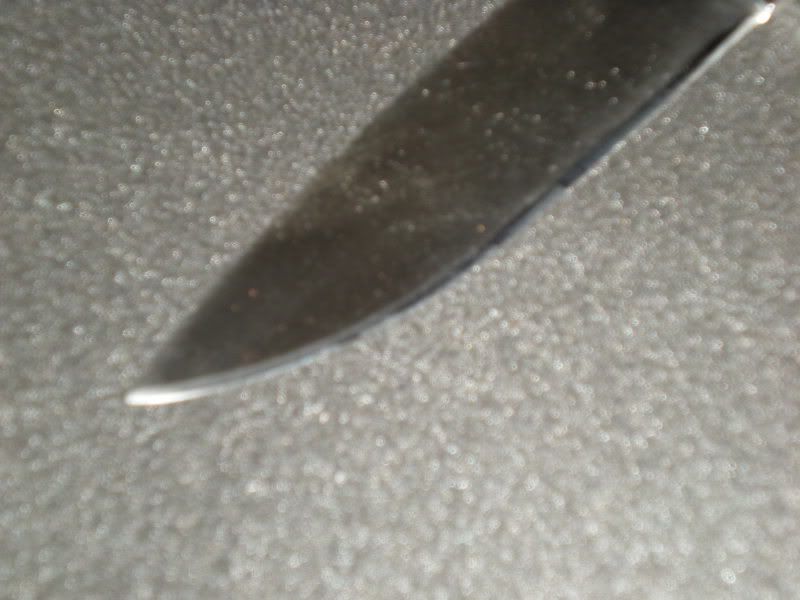

Well mine has a problem too; one of the holes wasn't tapped right and the bolt won't go in. I even tried another bolt and no luck! It doesn't affect the sander for my uses though. Rather than send it back I might just retap it myself.
Anyway, I'm having pretty good results. Most definitely start with cheap knives.

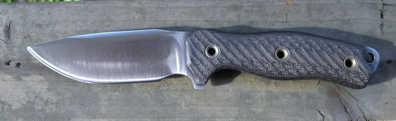

???How do you guys get the tip right? Do you use alot less force??? This seems like the hardest part for me to get right.
Anyone?
Re: Sharpening Thread [Re: imaginefj] #219586 02/27/09 08:58 PM
Anyone?
1 Maintain the same edge angle at the curve as you approach the tip that you had on the straight part of the edge but keep the belt perpendicular to the knife edge as you approach the tip.
2 Do not drag the tip across the belt. Stop when the tip reaches the outer edge of the belt.
Re: Sharpening Thread [Re: Horn Dog] #219587 02/27/09 11:32 PM
Posts: 183
BrianA Offline
Posts: 183
Another thing that might help you, in using a 1x42, x-weight belts are available. They have a stiffer backing. It can help when you reach the tip with the belt wanting to curl and grind your tip off.
HD has more technique on the tip since he learned to do it without them. I have always used them, then discovered how much harder it was without after the fact.
Still, even with the x-weights, I use the same technique as HD.

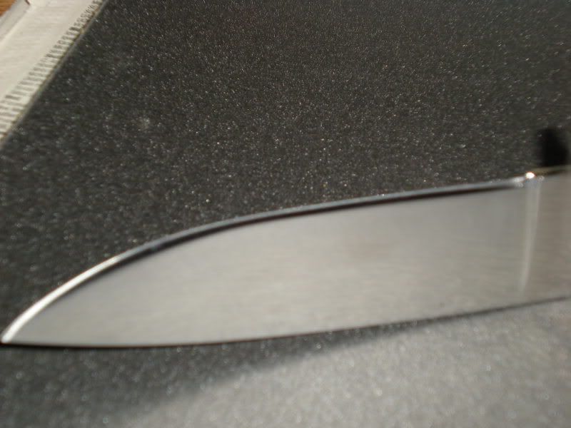

HD, Brian thank you for the help. I need to quit running the tip all the way aross the belt/pull the butt away at the end to maintain the proper angle. I went back and watched your videos again!

LOL Awesome information there! The Ryobi compound is actually black, but it says 1-3 microns on the side, as well as "for use when coarse buffing, removing rust, scratches, burrs, and pitts from hard metals." That would seem a little contradictory given its grit, but that's what I chose when I bought my piece of wood. Later I found myself at sears, so I picked up the green which is what I was looking for in the first place. White and pink seem like more than I want to get into. Black and green are the levels I was going for. The green rouge doesn't have any grit description on the packaging. It says it is for color buffing and light cleaning on all classes of metals. Maybe my colors/grits are backwards. I'd really rather pick these up locally. I can tell you that the craftsman compounds are about half as expensive as the Ryobi. I guess I could try Lowes and see what they have as well. Here's a link to Ryobi's compounds.
http://www.ryobitools.com/catalog/accessories/buffer_accessories?page=1
Re: Sharpening Thread [Re: StabbyJoe] #219598 03/08/09 08:16 PM
Posts: 1,558
StabbyJoe Offline
Posts: 1,558
Here's what I've got so far.
Last week I had my friend pick up a piece of pine 2x2 to use as my base. It was pretty damned crooked. So this week I got a piece of poplar. It was only a dollar or so more for a 2ft length.
So I cut it in half with the only saw I have here. I could have left it long enough to make a handle, but this is kind of an experiment, so I probably won't even stain it.
First Blood II was a great accompaniment.
Here's my awesome clamping system to hold the strops in place as the glue dries. I hope the rubber cement will hold. If not, I can always redo it.
Straight and FLAT is good. <img src="/ubbthreads/images/graemlins/thumbup.gif" alt="" />
If using leather with some thickness, a subtle curve won't hurt much though.... still flatter is better.

LOL Give me a break, I live in a 400 sqft apartment. Plenty of tools at my Dad's, I juts felt like doing it here. <img src="/ubbthreads/images/graemlins/smile.gif" alt="" />
This leather is easily an eighth of an inch thick.

The only real convex edge I have is my BRKT, which I'm not going to practice in. I was going to try convexing a Rough Rider drop point I have. Maybe I'll just use that one to test these out. I need to get some more cheap blades to practice with.
I don't know what a Rough Rider is. But, if it isn't too high end, go ahead and practice on it. With manual stropping being slower, it is harder to do too much damage quickly.
Although, if your black compound is as coarse as my black compound, laying the blade side down on the strop will scratch the sides comparable to 400-600 grit sandpaper.
Vic posts pics all of the time where he convexes the edges of a flat grind blade that originally had a factory V grind edge (like all Busse and kin blades have from the factory).
I also will do the same. In most cases, I don't take the time to turn a blade with a primary grind and secondary edge grind into a "FULL" Convex grind like my Bark Rivers and Fallknivens. But, I will most often Convex grind the edge where I grind the shoulder down between the edge and primary grind. The end result is like on the pics Vic posts where the edge grind becomes convex with a higher grind and more acute grind that "through" cuts noticably better than a factory V grind.
I do most (pretty much all) of my reprofiling on my belt sander. The Sander is faster, but pretty much the same concept in creating convex edges and most anything I do on my belt sander can be done by hand, just doing it by hand takes a LOT longer.
Here is my HR's convexed edge:
Re: Sharpening Thread [Re: KnifeGuy] #219605 03/08/09 10:36 PM
Posts: 2,375
snotpig Offline
Posts: 2,375
nice HR, KG. I like the useful choil. <img src="/ubbthreads/images/graemlins/thumbup.gif" alt="" />
Thanks SP.

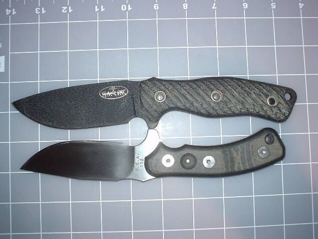

I did increase the choil size a bit, but the 2nd gen. HR shown above with the Res-C handles comes with a generally functional deep choil. I just pulled the choil in closer to the handle a bit - which by default increases it's size.

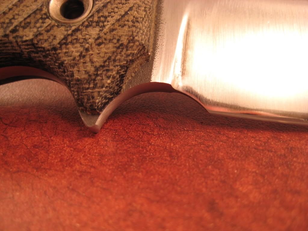

Honestly, I feel the choil is a bit larger than I prefer and it takes away more blade edge than I prefer. But, my modification didn't take ANY of the blades edge that wasn't already gone since I ground into the ricasso. And it just feels nicer in my hand now.
In spite of the amount of usefull blade edge taken up by the choil, I still like the 2nd Gen HR though. I like it's ergos, light-weight and I love SR-101.
However, as many long timers here will attest, I am generally not too big on choils on smaller knives. I prefer smaller knives to have the blades edge come up VERY close to my hand and handle.

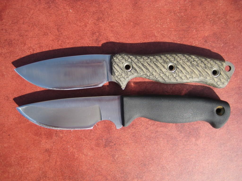

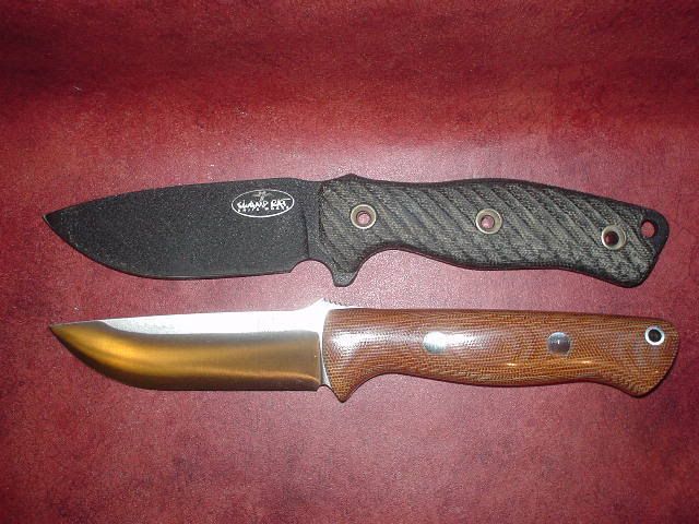

I wish I had an AD like this:
The Swamp Rat HRLM with micarta handles is an EXCELLENT knife except for one main flaw - that I am glad I am capable of being able to fix. The HRLM came with a horribly designed choil (IMO). It was way too large to be a sharpening choil and too small for fingers for choking up. But, again, I could fix it by enlarging the choil. Again, I ground the choil back into the ricasso and guard to maintain as much blade edge as possible. In the end, once modified, the HRLM is an AWESOME knife.
HRLM (old pic prior to stripping and modifying - to show original horribly sized choil for comparison <img src="/ubbthreads/images/graemlins/thumbdn.gif" alt="" />) with Bravo-1:
After stripping blade and modifying choil:
I also slightly modified the thumb ramp a bit to feel/fit my thumb a bit better:
HRLM with HR 2nd Gen.:
HRLM with SS4:
HRLM with Hairy Carry 3.5" and 4.0":

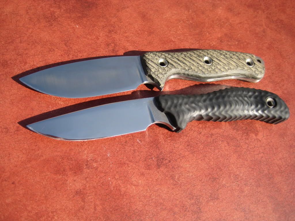

I used to have a Fehrman Peace Maker, but I sold it. <img src="/ubbthreads/images/graemlins/frown.gif" alt="" /> Unfortunately, the dang grip area in the handle was just TOO small for me. Otherwise a very nice little knife that I wish had a better sized handle. <img src="/ubbthreads/images/graemlins/frown.gif" alt="" />
[img]http://i80.photobucket.com/albums/j183/DWRW/SwampRat-HRLMFehrmanPeaceMaker-1.jpg[/img]

Found a few more older pics of my Howling Rat 2nd gen's edge that I didn't have up on my picture hosts site:
I think I mentioned somewhere up there about putting a convex edge on a flat primary grind. This is how I most often do it. Same as Vic and many others.
That knife cuts like crazy now! <img src="/ubbthreads/images/graemlins/thumbup.gif" alt="" />

here's the issue with the leather belts, notice the top pulley rubbing the frame in the first pic:
[Linked Image from sarcforum.com]

I have never had any luck with the leather belts on any of my sanders. I strop by hand. I noticed the platen is in place for bevel edges. For a nice convex, just loosen the allen head bolt and rotate it out of the way. That's one thing I like about the Delta. Nice shop. <img src="/ubbthreads/images/graemlins/thumbup.gif" alt="" />

I noticed that on some real cheap knives I had the green compound on leather really did seem to dull it. Polished the edge but didn't have the micro serrations that perhaps made the blades feel sharper. The knives I was sharpening really were junk. They are great for picking weeks though.

Keep working on it, I have the same delta and leather belt w/ green compound, and it always gets me the extra pizazz I'm looking for.

Gonna keep at it, the batch uproach was a mistake. If they all started out the with the same edge it may have gone better. I got really good edges on my kitchen knives.
How often should I be reapplying the compound on the leather belts?
How often should I be lubricating the Delta. It's starting to sound a touch "clanky" after about 7 hours of use, nothing major, I just notice a difference - I spent a lot of time with the 220 belt..... Come to think of it, might be other things vibrating on the table....

With the leather belt since it's thicker ans softer compared to the standard belts, you just need to find that sweet spot (the right angle with the right amount of pressure).
I don't really keep count of how often I reapply the compound. I can feel the difference with the edge when the compound is worn out, and when I feel it's not abrasive enough, I apply more.
I keep the side cover off my delta as well, i try to vacuum as much dust as possible from all the moving parts to keep everything running smoother, but I haven't had to do any maintenance except tightening the drive belt. See if that helps transition the the power more smoothly, because the belt does get more slack from when you first assemble it.

I guess its time for an update. Here's my strop so far.Two leather sides, one mousepad side. Plus my awesome cardboard strop.
My attempts to photograph the edge I put on my Rough Rider are pretty much a fail fest. The last couple aren't so bad.
Its really not cutting the way I want it to. Somehow the third toward the tip is pretty good, While the other two thirds are kind of mediocre.It slices pretty good, but doesn't push cut or shave well. For as pretty as the edge looks, I'm not impressed with my work thus far.
Re: Sharpening Thread [Re: StabbyJoe] #219639 04/04/09 12:50 AM
Posts: 2,943
KnifeGuy Offline OP
Posts: 2,943
Sharpening can be frustrating. <img src="/ubbthreads/images/graemlins/blush.gif" alt="" />
The theory and concept is pretty simple, but the actual results can be evasive sometimes. <img src="/ubbthreads/images/graemlins/crazy.gif" alt="" />
I think it often comes down to the steel - especially when doing it by hand.
There are so many different steels with different hardness, carbides, etc. Many just seem to require a bit different technique. So, often, you will find some steels that you can get a great edge on and turn around to try the same technique on a different steel and have quite a struggle with it.
... other times, you just keep getting what you want. <img src="/ubbthreads/images/graemlins/thumbup.gif" alt="" />
I have mentioned cardboard strops and similar rough paper strops. I continue to be amazed with the results I can get on cardboard and rough paper. <img src="/ubbthreads/images/graemlins/wink.gif" alt="" />
Keep at it and try to have patience. It will come. <img src="/ubbthreads/images/graemlins/thumbup.gif" alt="" />

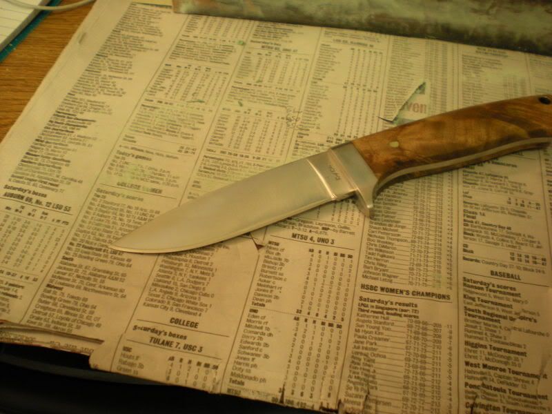

Here is another.

I am getting surgical sharp edges by using a flat piece of cedar roof shingle, with a bit of green compound rubbed into it (on the sawed flat side) . Cant explain it, but the slight fuzzy surface really gets rid of the burr quite well...
