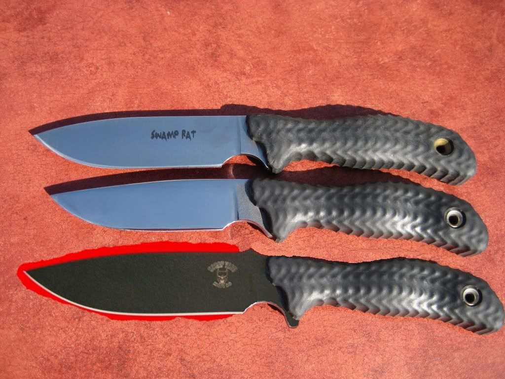

Personally, having both the Bog Dog and SS4, I find a having a choil to be "acceptable" on this size knife with mudders. To me (IMO), the Mudder handles have a very NATURAL design for choking up into the choil, but I would rather have certain changes made to the choil shown on the S5 "Proto":
- Rounded choil (not square) for better feel and comfort
- A smaller choil - to a reasonable size that doesn't waste blade edge.
- Closer in to the handle with no guard extension - like on the Bog Dog and SS4
- The guard is NOT needed in this knife IMO. And it creates at least three negatives IMO:
a) The knife is not going to be as comfortable in the choked up position with the guard as it creates a larger than natural gap between the index and middle finger when choked up.
b) It pushes the blade edge even FURTHER away from the regular grip
c) It reduces the amount of usable sharpened edge by being larger than needed.
I suppose in all fairness, "Some" might like the guard. For those who view this knife as a fighter, then I suppose a guard might protect your fingers from another blade's edge..... for those who honestly believe they might use this in a knife to knife fight..... <img src="/ubbthreads/images/graemlins/rolleyes.gif" alt="" /> - However, personally, I try to focus my knife design preferences on how I KNOW I will use the knife. This knife could be used defensively if needed. But, I don't honestly or seriously believe I will ever be in a situation to have to go toe to toe in a knife to knife fight. If so, the odds are that in that situation, I will be stuck with my EDC folder anyway. So, I vote for a more usable and ergo friendly non-guard design like the Bog Dog and SS4. <img src="/ubbthreads/images/graemlins/thumbup.gif" alt="" />
Also, some may feel the larger guard might help keep their fingers from sliding up onto the blade. Fair arguement for some in some cases. However, if this is a concern, I would rather a design for a guard be MUCH thinner front to back with just a slim protrusion of a guard dropping below the Res-C.
Forgive my crappy "Hurried" Photo-chop, but something like this:
.... I could clean up the photoshop a lot, but since it may be of NO value, I won't waste my time unless Dan needs me to - in which case I will GLADLY offer my services and time on this AWESOME project for free. But, even if Dan is interested in changing the choil, I doubt my services are needed on this. I assume the general idea is clear.
*** Basically, the choil on the SS4 and Bog Dog works very well. I vote for sticking with that.
